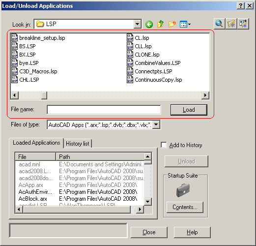

Hi alanjt.....I can not seem to get the lisp file to run you have there.....
Too vague. :wink: Don't know how to load it or can't get it to work, upon loading?
Use/Load LISP Routines
Hi alanjt, I have finished work now.....so hope I'll get it going tomorrow, thanks for your help,
Ian
Hi, Still can not get this one to work. I have called the file SB.lsp, load the file and get nothing when I type SB in the command line? Probably something I'm doing wrong as I'm new to lsp commands! Wish I'd used these sooner I've been on CAD since R13!
Not to sure why this will not load properly, MSASU's lisp file loads fine and runs, but alanjt's lisp code states loaded succuessfully but obviously doesn't as when I go back to check if its loaded its not listed. Any ideas?
When you say you load it, are you using appload and loading it or adding it to your startup suite? Also, what does it return when you type SB at the commandline?
I load it by the link posted here on how to load. I type SB and I get 'unknown command'. But when I go back to check if the SB.lsp file is loaded it is not, so really confused as it retains the lisp file submitted by msasu just not SB.lsp
Are you loading it here? APPLOAD
yes I am, but states successfully loaded, I go back in to check as it does not work and it has disappeared?
just checked command window, I get application loaded successfully followed by malformed list on input
Ah hah! That means you missed copying a paren. Recopy what I posted and try again.
