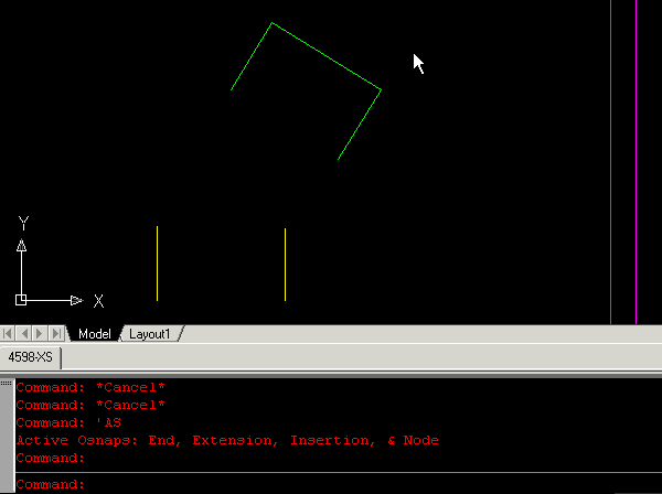

Hi, I am a fairly new user to AutoCAD. I am sketch out a plan I drew of a street. I am trying to join two points of an object to another two points of a separate object. I have looked online but haven't found a solution so far. I have included a print screen of what I have so far I what I intend to do (highlighted in red).
I do not want to extend the lines to join the points but expect the angle of the above object to change. Any help would be greatly appreciated, thanks.
You want the two points to 'join' but you don't want to extend the lines? Try MOVE from end point to end point or stretch the grips from the end of one line to the end of the other.
I may be confused as to what you want to accomplished.
If they are plines you can 'JOIN' them...
Thanks for the prompt replies, I will try out your suggestions. Is it not possible to use "MOVE" to join one of the points and then use "ROTATE" to join the other...?
You can use the ALIGN command to accomplish both tasks at once.
I just saw that in the modify menu. What steps do I need to take exactly to execute this.
Ahh ok, I think I've got it. Thanks.
