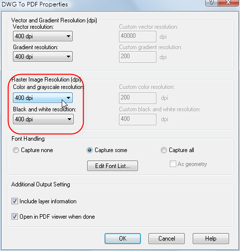

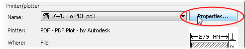

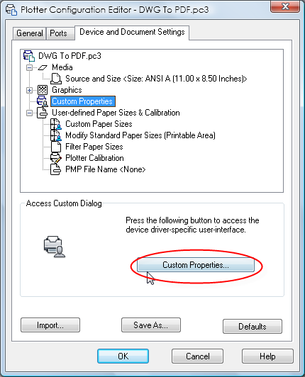

You can play with the quality settings by opening the plot dialogue, picking your printer and clicking on the 'Properties' button. Next choose 'Custom properties' - see screen shots attached.
The screen shots are for PDF - Image files are slightly different, but you get the idea.
