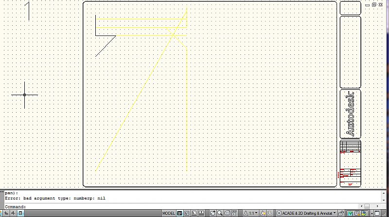

While trying to place a ladder, I get the error "bad argument type: numberp :nil." I also get a large rung number and a few squigly lines. I believe I have all the drawing format values correct but what am I missing?

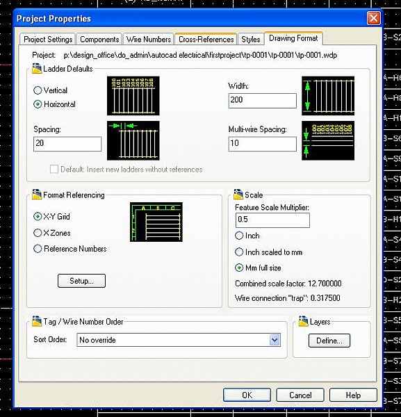

what values do you have? Mine is like this (although I haven't used an automatic rung & ladder yet).....
Spacing=1
Width=11
Multi-wire=.5

It looks like it is trying to draw the ladder extremely large.
tedious I know but compare each setting in turn. After I posted that screen shot I tried adding a ladder and realised the dialogue box didn't default to the project properties so I too got a very large ladder with just one rung (but no numberp error).

I've matched drawing formats and insert ladder settings and I still get an over-sized rung number and the ladder is drawn too big and with diagonals randomly placed. Anybody else seen this. I can add ladders to existing drawings with the same settings and it works fine. Also the grid appears to be larger than the sheet.
oooh, that isn't right!
