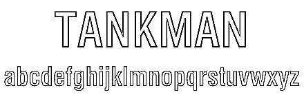

ReMark Posted May 18, 2010 Posted May 18, 2010 I am interested in a font either exactly like this or very similar. Must be the outline of the letters and it must include upper and lower case letters. Does anyone have a font like this or know the name of the font? Thanks. Quote

fahim108 Posted May 18, 2010 Posted May 18, 2010 It seems to be a custom font, somewhat related to DilleniaUPC Bold (a thai font). But I could not find an outlined version of it... Looks similar though, when outlined using Paintshop, (except for "s", "t" and "k") Quote

Rebel Posted May 18, 2010 Posted May 18, 2010 Try http://new.myfonts.com/WhatTheFont/ You can upload an image of the word and it tries to search fonts for you edit: I went ahead and ran the search Link and it didn't turn up a good result. Often times with company word marks, they are a custom image loosely based on a type of text. Quote
fahim108 Posted May 19, 2010 Posted May 19, 2010 Wow! Rebel... that's a cool site... I tested the font, and guess what! Got impressive results. Looks like VigorDT to me... Quote
Tankman Posted May 19, 2010 Posted May 19, 2010 Looks a bit like this font. Quite similar anyway. Quote

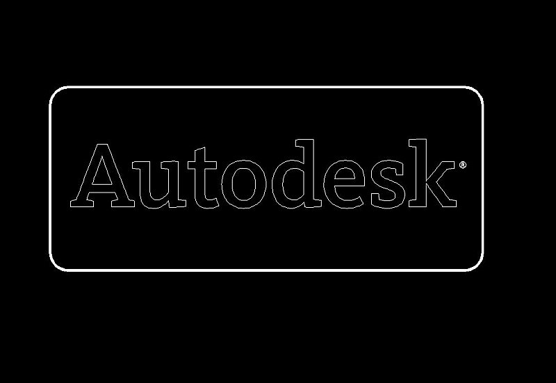

ReMark Posted May 19, 2010 Author Posted May 19, 2010 The task has been completed. My solution was to forego looking for a suitable font elsewhere and use the Times New Roman TUR font that is already available. To achieve the "outline" look I exploded the text (that got rid of the "fill") then edited it for bits and pieces of stray lines. Finally, I went and did a Pedit/Join on each letter just so if I had to work with them on an individual basis I wasn't dealing with disconnected polyline segments. But I do thank you all for your input and as always I learned a couple of new tricks along the way and got the chance to visit a couple of new font websites. All-in-all it was very worthwile. Quote
Tankman Posted May 19, 2010 Posted May 19, 2010 ReMark: Post a sample of your home grown font for all to see. What extension did you use for the newly created font? Quote
Tankman Posted May 19, 2010 Posted May 19, 2010 Very nice ReMark. Wouldn't expect less from the King! :wink: Quote
