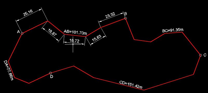

I am using Civil 3d 2008 and i am looking for a way to "dimension" a polyline between specific vertexes.
For example if i have a polyline with 50 vertexes and i need to write the length between vertex 1 to 5, then 5 to 12, then 12 to 24 etc. I don't need the dimensions between every vertex but the length of the polyline from vertex i give to another vertex i give. This length must be writen above (in the middle) the measured length. Until now i was doing it manually. Break the polyline==> list==> add text with the length. But it takes to much time to do that. Is there any way to do that quicker?

Lee Mac and Alanjt, thanks for your quick responce. Unfortunately those lisps doesn't work for what i need to do. Maybe i didn't make my self very clear (my english are not so good). I attach a foto to make it more clear. Let's suppose i have the red lwpoline, and the points A,B,C,D. What i need to do is write the length of the polyline between the points A and B (101.70m), B-C (91.35m), C-D (151.42m), D-A (77.86m), not the "dimaligned" between the vertexes. I hope you can help me.
George.

Is it posible the distance between the two points to be writen above the polyline and in the middle of the points?
