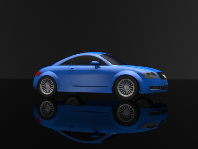

I prefer Solidworks all the way. My biggest problem with inventor is spline control. Solidworks spline control is much better(in my opinion). Also when modling something like this you work with a lot of projected curves(projected from two different 2d sketches). Solidworks has a curves function that lets you project 2 sketches. The feature in the tree "consumes" the 2 sketches. In Invnetor you need to draw both 2d sketches, then start a 3d sketch and project them in the 3d sketch. Its not as clean, especially considering even a simple panel will have 4 projected curves which is 8 2d sketches. The audi tt right now has somethin glike 300 features and there are nearly 100 different surfaces so it adds up very fast. And i think the renders look a million times better. No to mention its much easier to make a good looking render with Solidworks. Here is an audi r8 i did in inventor. I spent a good bit of time setting up the render and it still looks awful.
and attached is a tt im drawing in solidworks. render setup and render time was under 5 mins.

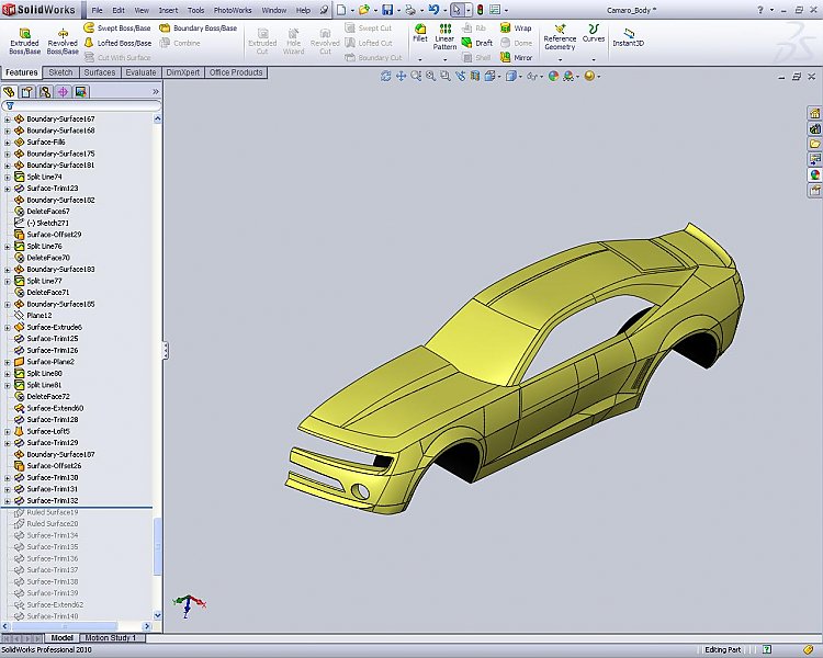

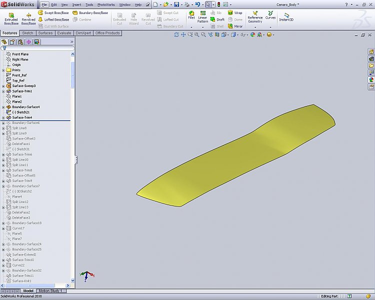

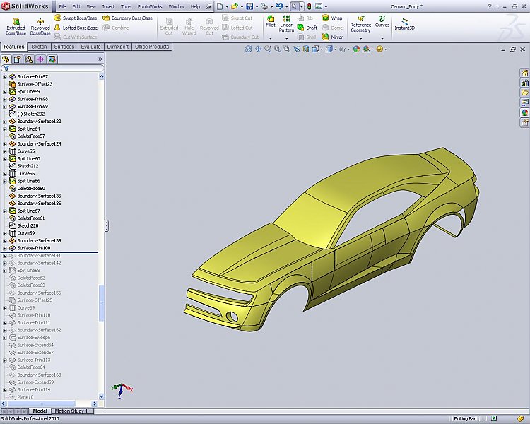

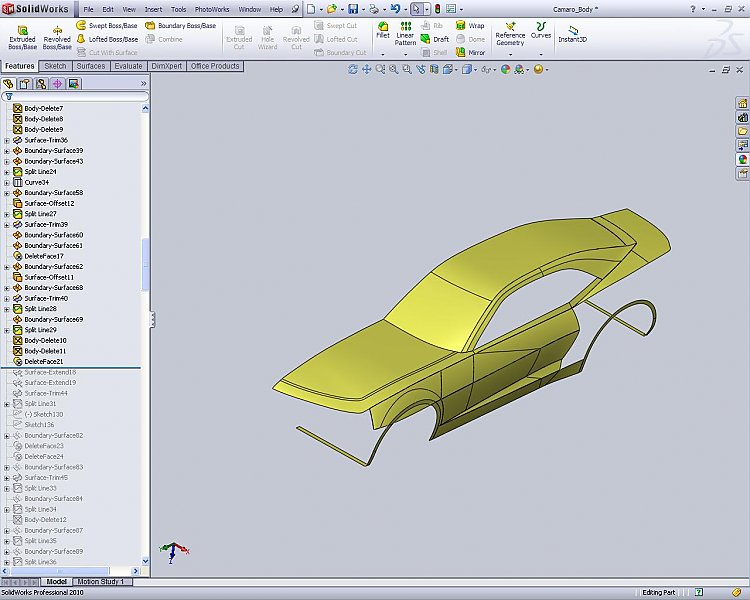

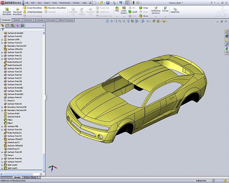

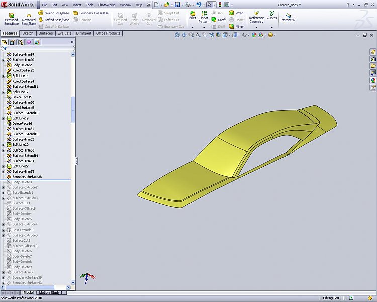

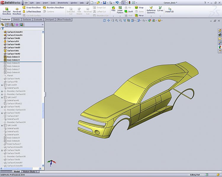

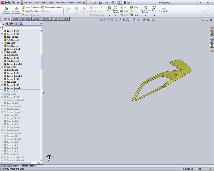

I probably already asked you this but i would like to know what parts you modeled in what order. Like did you start with the door, the roof, the hood and so on. The direction im going is door/front 1/4, rear 1/4, fender lips, hood, nose cone, roof, apilar, cpilar, trunk and rear bumper. Im sure it will change but thats how i envision it going.
Matt,
Attached are photos that show my modeling approach. I thought it would be easier to show than to explain the build procedure. You may notice that the surfaces in last picture are better in appearance than the previous ones.This is because I came back and remodeled surfaces that were not up to par. This is why I explained the feature tree needed to be cleaned before I could share the file. I hope it can help. Good luck.

great way to show that bill. Is the first surface your roof? One trick you may or may not know, when using edges of existing surfaces as guides or rails, you can drag the green or pink end dots and only use part of them. This may save you later on from making split lines to get your edges where you need them. Unfortunately you can not(i dont think) drag the end points if you are using them as cross sections.
