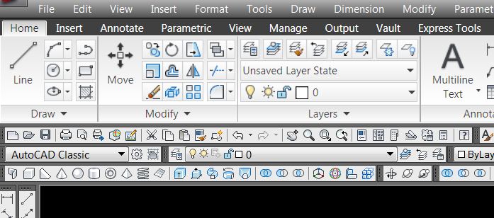

You can add tool bars below the ribbon.
This what you mean?(2010 version)
At times this is quicker for me.8)
Appreciate the help, but not quite haha. The tool bar I'm after only pops up above a table when you click on it
Found it,
