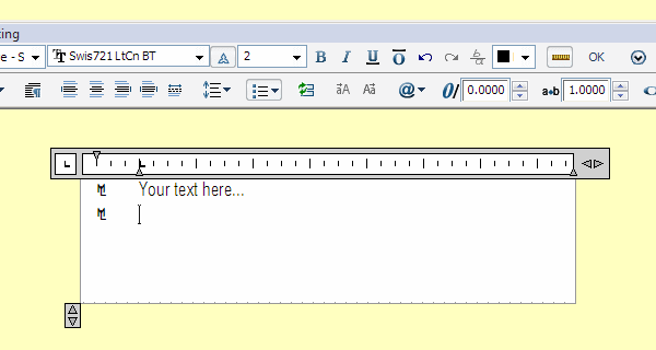

Here is a screen grab:

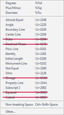

Moreover, some symbols may not support this function, as the ones that I have lined-out.
