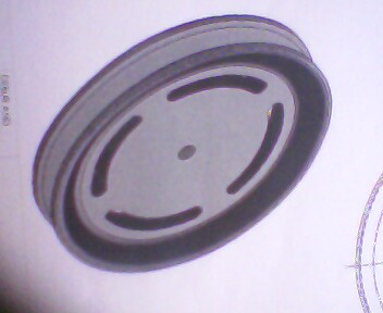

endlasuresh Posted May 14, 2010 Posted May 14, 2010 I am now trying on autocad 2010 but i havent getting where to start for making circles.I am attaching an image but it is not clearly visible at all for dimensions Their are few more images for this diagram ill add them in next posts. here are i am giving diameters for this drawing 50.43 57.05 63 65 R22.50 R19 tell me how and where should i start drawing Quote
kencaz Posted May 14, 2010 Posted May 14, 2010 Probably best to make a profile (in Yellow), of the wheel to revolve. Then it's just a matter of making the slots using arc's and trimmed circles then using polar array for the pattern. The rest is just a matter of press-pulling the slots through the wheel and creating the boss feature. Fillet the inside edge and your done. KC Quote
MikeScott Posted May 14, 2010 Posted May 14, 2010 I don't think he's doing 3d..? otherwise I'd expect a section or at least a side view. You want to draw two guideline crosshairs for the center of your circles. Then draw all of your circles from that intersection. ie- The circle command.. just type: CIRCLE (to start the command) INT (within the circle command and most other commands) uses the object snap called "intersection" to help you select the precise intersection of the guidelines you drew) Then look at the command line and see what the circle command is asking for now. It's asking for a Radius or Diameter (the one in brackets is an optional way to enter the data.. the part NOT in brackets, is what it's expecting if you just give it a number value.) Plug in the appropriate number, hit enter (or space), and BLAM! there's a circle sized as you wanted it. Do it over and over, and you've got most of it done. Quote

endlasuresh Posted May 14, 2010 Author Posted May 14, 2010 though i have drawn by entering number of times circle command.anyway let i will further draw mikescott i have missed your points do you mean crosshairs is to draw two lines of intersection ? i am drawing plan view then i look forward to draw 2d or 3d could you tell me how to cut those arcs i used previously fillet but i forgotted well i go previous thread and check it Quote
ReMark Posted May 14, 2010 Posted May 14, 2010 It would really help if we could see the dimensions clearer otherwise we have to guess. The "arcs" can also be segments of a circle that have been trimmed. Quote
endlasuresh Posted May 15, 2010 Author Posted May 15, 2010 the space between those arcs is 10 mm.see the first image their you can see the space but those space is before the trimming.ill try to capture them clearly or else will get the diagram from the company Quote
ReMark Posted May 15, 2010 Posted May 15, 2010 It looks like you have failed to provide diameters for the first three circles starting with the (solid) innermost one and the next two (dashed) ones. Any additional info for locating the four slots? Quote
endlasuresh Posted May 16, 2010 Author Posted May 16, 2010 I understood and i havent given those things since capturing is too hard and this product was just changed by the company but it was in thickness only and the circle radius are all same The second dashed ones was diameter 24 as in the diagram written The small hole and then next dashed ones that was not written in the diagram.Ill contact to them and let you know. why this dashes are came ? I may think both dashes have same size of circles.Is it correct ? Quote
