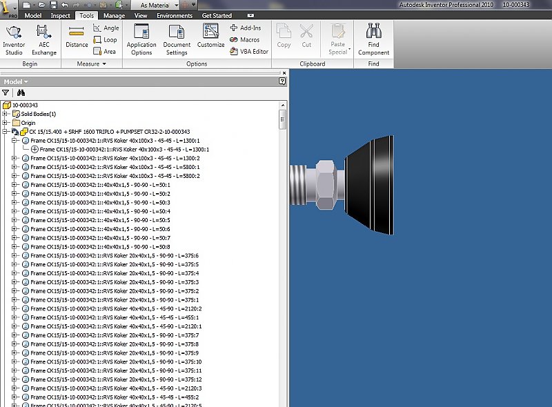

I've attached a screenshot of what is in the feature tree. I can't see any folder that says solids?
Oh wait, there is a solid bodies folder? How do I break this down using the manage tab?
That little icon next to the CK is the combine icon meaning he made all the pieces into one solid.
what modification do you need to make? what else is in the feature tree if you collapse(minus sign) CK 15/15.400
I'll have a look, I've shut it all down now. If he has made it all into a solid, is there any way to undo this? I need to take 'blocks' of this without having to redraw it. Unfortunately there is no way I can get in touch with the guy who created this.
It is a Derived Component from an assembly with the Link broken. They might also have used shrinkwrap to remove some details and fill voids between solids.
This process is normally done to offer some measure of protection of intellectual property.
You might be able to separate some parts with clever uses of Split or Sculpt, but it depends on how much detail was lost in the combine, how much is known about the actual geometry (what is this thing), ... ... in any case probably not a job for someone with so little experience using Inventor that they do not recognize a Derived Component....

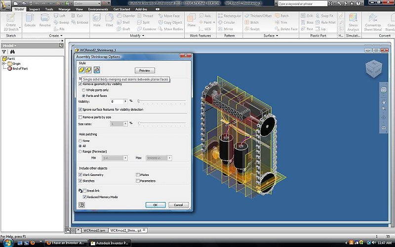

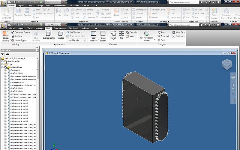

Ste, when someone shrinkwraps an assembly its meant to provide a simplified version to help reduce memory consumption(in most cases). For instance if you have a large assembly that includes a number of sub-assemblies, but these sub-assemblies are really only needed for scale/placement purposes, you could shrinkwrap a simplified "dumb" version of these. If you look at the image there are a few options. At the top you can see the combine icon which i left the cursor on so you could see the description. This assembly is another users assembly but i felt it was a good example. The second image shows after the combine. Pretty much the only thing there is the case. So even if you were able to split things apart there is no way for you to decipher how he made the parts or put them together really(unfortunately).
