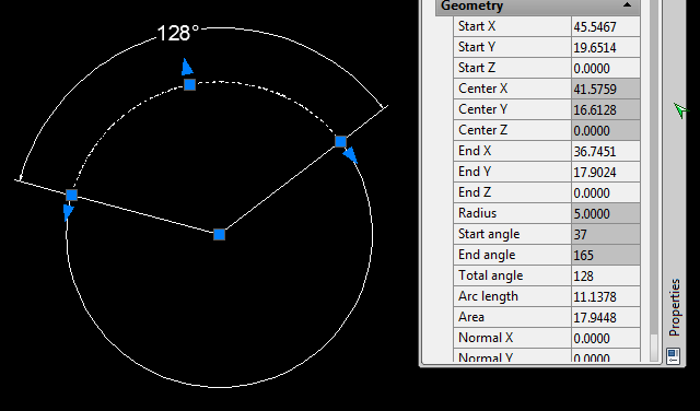

Well. In AutoCAD, if you want to get the length of a segment of a circle you can determine without trimming out the arc to get the "Arc Length" in properties.
Circle = 10 dia.
10*3.141597 = 31.4159 (just as Autocad reports it)
now divide
31.4159\360 = .087 per degree
therefore an arc segment of 128 deg is
128*.087 = 11.13
As reported in Autocad:
Can be useful if you don't want to trim your circles to get an arc segment length. just get the angle.

In traditional drafting you would divide the arc into equal length segments. This might be done by taking a pair of dividers and setting them an arbitrary distance apart. Then you would start at one end of the arc and swing the dividers around to the arc, 'walking' along to the end of the arc. If there was a space left then you adjusted the dividers and tried again. When you got it close enough you could measure the distance between the points and multiply or use the dividers to 'walk' along a straight line the same number of segments.
With AutoCAD you list the arc and draw a line that length.
Or use the divide command on it to place equally spaced nodes on the arc (as many as you want).. then erase the arc, and use Line or pline to connect the dots.
May as well draw a polygon with x number of sides from the center line of the arc to a quadrant. Break it using the arc for start and stop point.
