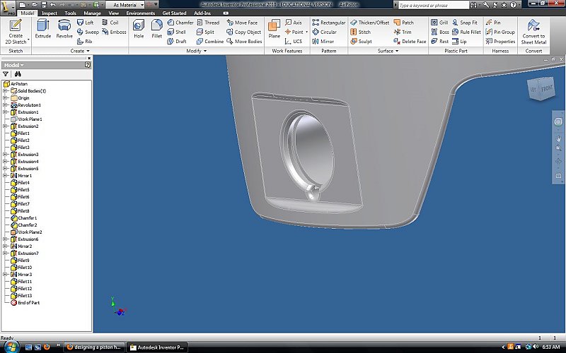

Should be quick work with Solidworks. I am an Inventor person myself, however, it's basically the same.

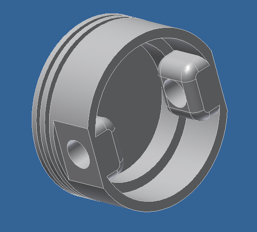

I drew this up in a couple of mins. crude but you can get an idea.
I revolved it but it's probably easier if you just made a solid cylinder, shelled it then added the bosses for the pin holes and then revolve cut for the ring slots.

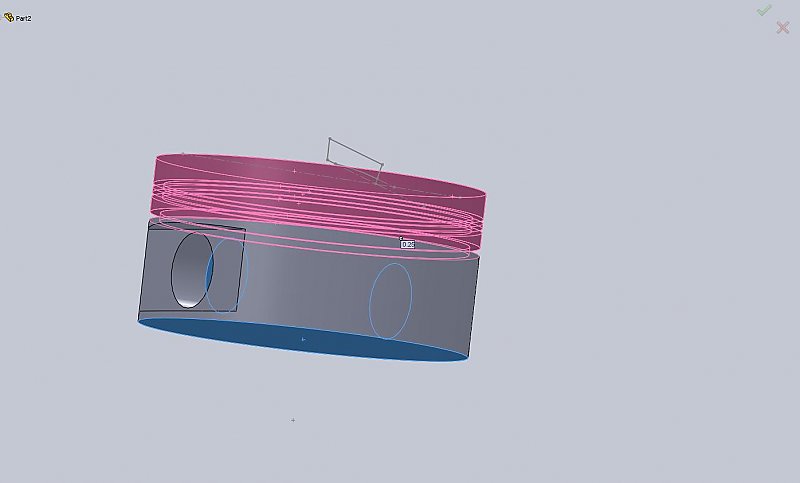

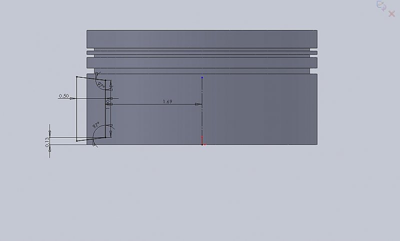

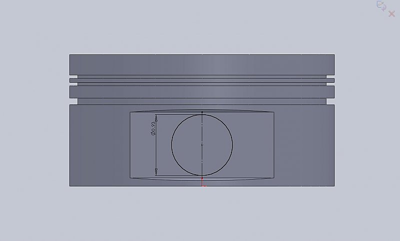

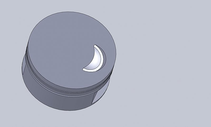

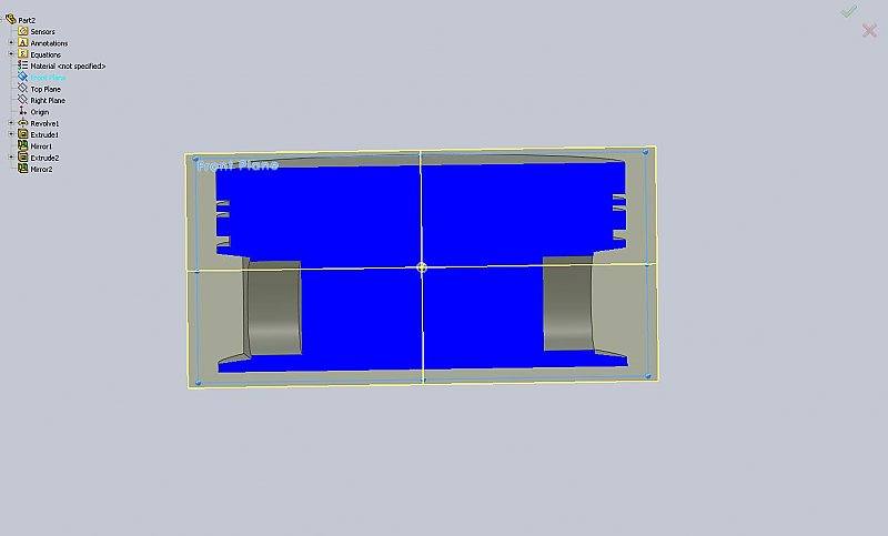

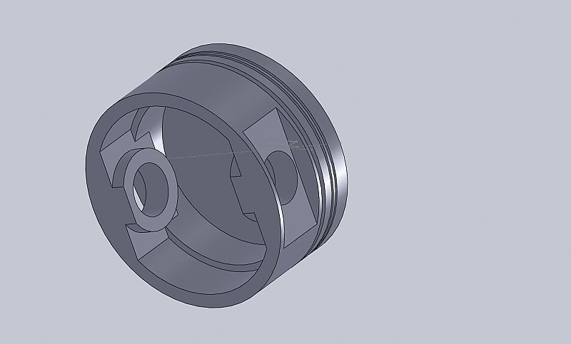

Here are a few pictures to get you started on the right path.
1. profile for the revolve.
2. sketch for cutout area for piston pin. After it was cut, the feature was mirrored to the other side.
3. piston pin hole.

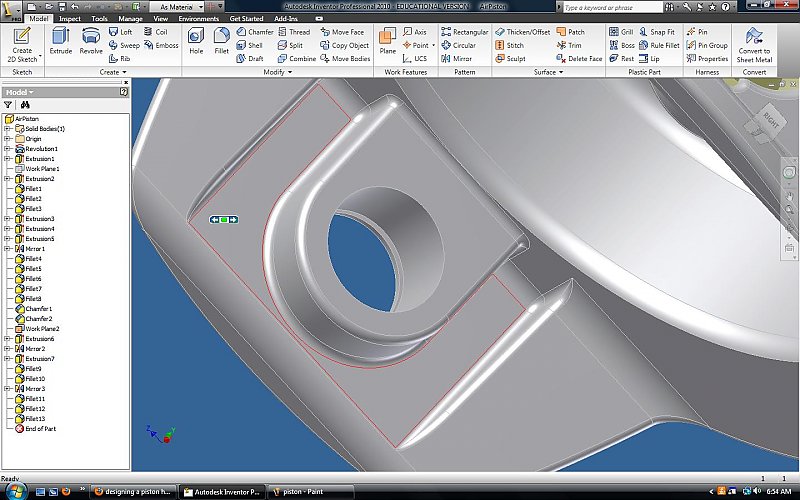

4. cross section showing that i only cut the hole part way into the body and mirrored it to the other side. This is because of the shell operation. You cont need to use shell, you could revolve the inside and outside of the piston, then add material for the piston pin. It really depends on what the underside of the piston looks like.

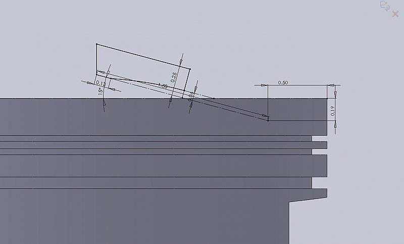

5. This is a sketch for the valve relief cut. The picture is out of order, i didnt cut the valve relief until after the shell operation. This was a revolve-cut.
6. selection for the shell operation. Blue are faces to remove. Pink are multithickness. I had a .25" shell and the pink faces got more material.
7. view showing the shell.
8. view showing the valve relief cut.
planning out the underside without a piston is tough.
