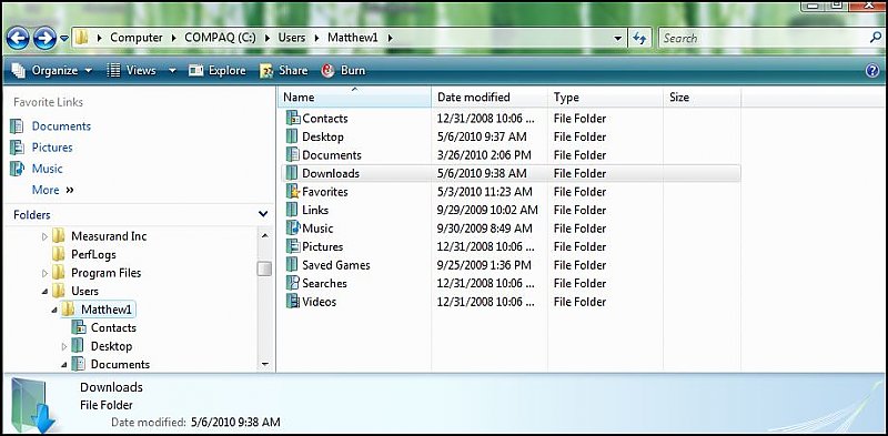

mdp198 Posted May 6, 2010 Author Posted May 6, 2010 Well no errors are produced when loading AutoCad, as seen from pressing F2. However it looks as though my Tool Palette Path (and possibly others) may be pointed wrong or missing. Please see the following attachments. Cad wants C:\Users\Matthew1\AppData\Roaming\Autodesk\AutoCAD 2008\R17.1\enu\support\ToolPalette I have C:\Users\Matthew1\ (no app data folder and so on.) How does that happen? I have re-installed the program and re-paired at least twice Do you know if Autodesk provides user support for something like this? Quote
MikeScott Posted May 6, 2010 Posted May 6, 2010 It's a hidden folder.. you're just not seeing it. That shouldn't stop the program from seeing it though. I'd still take a peek to ensure they're where you think they are. That's Vista isn't it? You'd need someone else to instruct you on how to view hidden files/folders (unless it's still in the "view" pulldown on the top menu on your "files browser" or whatever you wanna call it.) Hey.. doesn't Vista have a security setting that requires you to have permission to access your user folder? Maybe it's denying AutoCAD access and not telling you about it? I suspect AutoCAD would be missing all kinds of stuff if that were true though. Maybe there's a Patch for that? are you keeping your patches/updates up-to-date? Wait a sec though.. why would pallete menus be thrown into the various user folders anyways? I thought they'd go into the main install directories by default, otherwise other users can't see them. That may not be a problem for you (unless you're not matthew ) but I imagine it'd inconvenience SOMEONE down the line. Quote
mdp198 Posted May 6, 2010 Author Posted May 6, 2010 Well I got it figured out. No problem with vista but I think something must have happened during the installation. I had all the materials/objects and such listed in the file folder, however each item was 1KB in size. When comparing to a colleague's (running CAD2009), his Palettes folder had much larger file sizes. So a simple copy and paste swap seems to have done the trick! Thanks for spurring me in the right direction! Quote
