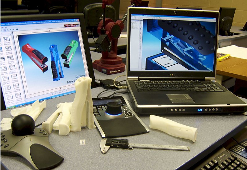

I have been using every version they make (we have more than 50) for several years (attached picture is 4 years old). There are 32-bit and 64-bit drivers. In my opinion no one doing 3D should work without one.
One tip - I almost gave up on my first one with the out of the box default settings. I was about to give up on it and put it in the box after two weeks of frustration. Decided to give it one last try altering the pan/zoom direction settings and was flying like a pro within minutes.

The one on the far left in jds picture is the one I used.
