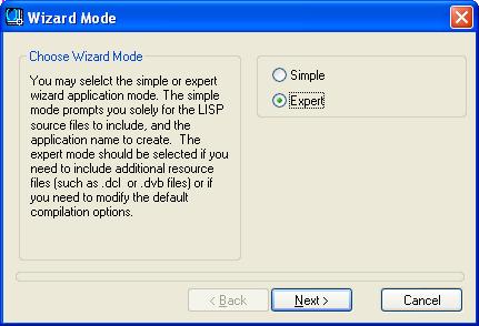

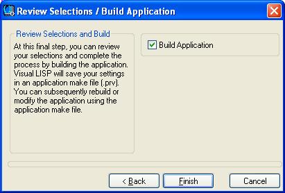

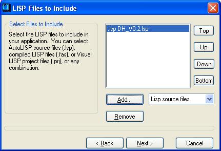

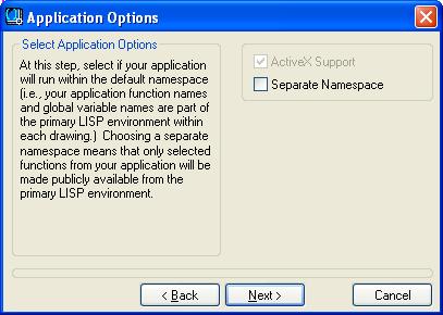

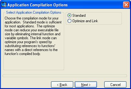

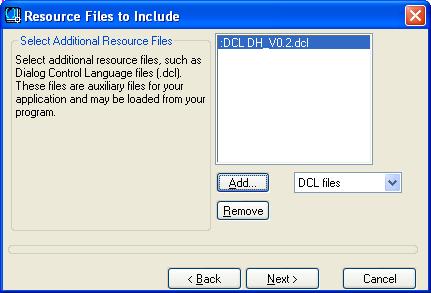

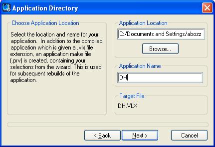

I would like to hear more about compiling in to a VLX or FAS if you would care to elaborate. Thanks.
Got to go. Promised the wife I'd take her to lunch. But...I'll be back.
Just go to VLIDE editor in ACAD and choose Make Application, Follow the instructions on each dialog (See Sample Images). Attached at the bottom is a zip folder with all the files. I have included a VLX & FAS for your choice.
DH_V0.2.zipFetching info...

  The Buzzard said:
Hey Tankman,
Just keep both files together and make sure that the directory they are in is in the ACAD Support Search Path. You can do this under Options file tab (See Image Below) or you could just put the files in any of ACADs subdirectories, But I would not recommend that.
This link also has information on loading lisp files with dcl:
Refer to Lee Macs section in post 2 on additional loading instructions.
http://www.cadtutor.net/forum/showthread.php?t=1390
