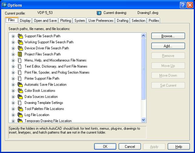

Hey Tankman,
Just keep both files together and make sure that the directory they are in is in the ACAD Support Search Path. You can do this under Options file tab (See Image Below) or you could just put the files in any of ACADs subdirectories, But I would not recommend that.
This link also has information on loading lisp files with dcl:
Refer to Lee Macs section in post 2 on additional loading instructions.
http://www.cadtutor.net/forum/showthread.php?t=1390
I put both files in C:\Program Files\AutoDesk 2010\Support.
That will work, But as I said I do not recommend doing it that way. If you ever upgrade your CAD version, You could run the risk of losing the programs.
