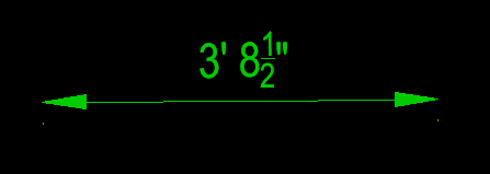

I am using the following in the text override field for a dimension:
3'-8\S1/2"
And this creates 3'-8 1/2" with the fraction as a horizontal format. What I want is a diagonal format for the fraction. What is the proper syntax for this.
Like this (forgot the hyphen)?
You can just type the "1/2", highlight>right-click>choose Stack. Is this what you are trying to accomplish?
Thanks but that doesn't really work in my application. I'm making this text entry in the text override window of the properties window.
The attached file shows what I'm talking about. I would like for the fraction in the dimension appear like the diagonal fraction in the text. Right now the only way I can get the fraction in the dimension is to use the text override feature and this ends up with a horizontal fraction, not a diagonal one.
