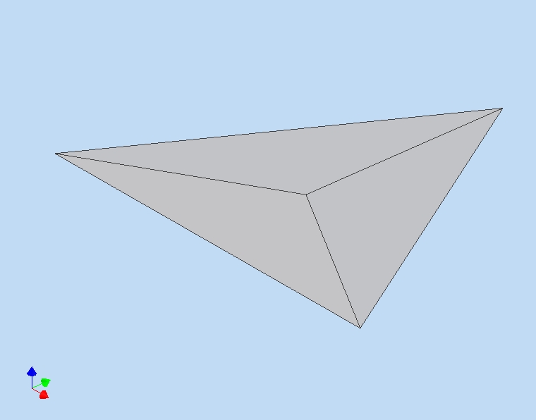

I'm not familiar with the all business of sheet metal. When a face is big needs to be “faceted”. ( I don't know the right term) So to say, it mast be pressed out as a shallow pyramid, this is to avoid drumming effects. See pic. How is that done in inventor?
Later versions of Inventor have Cross Break (cosmetic).
Thanks JDM. I'm about to upgrade to IV 2011. can't wait.
