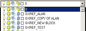

XRefsToLayers.LSP [Move XRefs to corresponding layers]
Inspired by this thread.
Will move all XRefs to layers, based on name and prefix of "0-XREF_" (can be changed to whatever).
Prompts user with option to lock XRef layers.
When completed, prints number of XRef moved to each layer.
Example of created layers:
Comments and criticism are always welcome.
Enjoy guys. :)
XRefsToLayers.LSP
Edited by alanjt

A slimmed down version. BTW, you are defining the layer database for each object you step through and you leave layers you unlock unlocked. Not a big deal, just thought I'd make you aware.
I made it simple, because with multiple checks, you lose efficiency and speed
If the layer is already locked, not serious as it is the result we want
I also used a list to the list of layers and xrefs, easier to handle and faster.
I just kept the strcat the variable s because of ssget, otherwise it would have been as a list
I also used subtle or as a condition of multiple
Also look at how structured the lisp and the logic
You have a good level and very little to learn lisp.
Simplifies just a little what you do because you have an error handler that is not justified.
I appreciate your comments, but I would say my only redundancy is my list check at the end. I could remove it before issuing the lock to all XRef layers and the alert, but it's minimal and is a nanosecond of a setback at best.
I like your use of or for your conditional.
You do realize that what you have modified the code to do is to only lock/unlock the layers XRefs reside on. Mine actually creates and puts them on layers pertaining to the XRef name.
And I would say that my *error* handler is justified.
eg.
Command: x2l
XRefs To Layers
Lock XRef layers? [Yes/No] <Yes>: *Cancel*
Command:
Command: u
Start of Group encountered.
Must enter UNDO END to go back further.
However you could avoid this if you moved your undomark between the progn and your step through the active selectionset, but I prefer to wrap it in an error handler to avoid this all together.
To each his preferences :)
