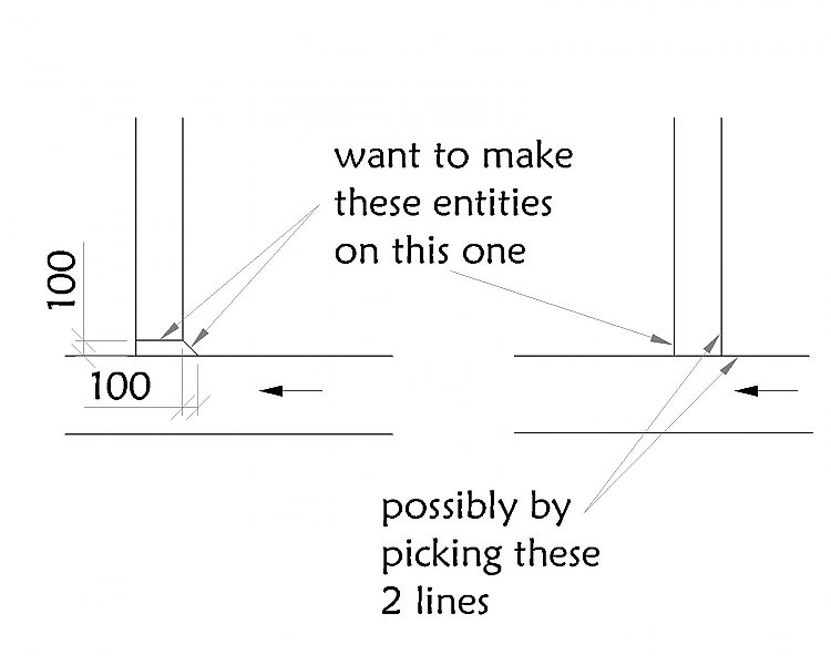

To all of the HVAC guys on Cadtutor
Does anyone has a lisp to draw a branch duct.
Thanks in advance
Vivian
Try this out

Thanks Fixo
It works very well.

doesn't work for me...
using vanilla acad2008
what are your settings, units, scale, etc.
the "fillet" goes way off and too large
thx

Sorry for the late reply.
I m using AutoCad 2010. with metric (mm) units
It works very well for me but does not works with my colleague who is using 2008.
Are you also into HVAC ??

I'm not into HVAC, I thought if I could understand and get it to work, I'd pass it onto some of my lisp challenged HVAC colleagues a few desks over. I'm using ac2008, I guess that is why it "tilts".

I tested it on A2008 (eng) with metric only -
it's working good on my machine, FYI

I agree with the above, but when using inch or feet units on the drawing, the "fillet" is HUGE !! and way out of proportion !
