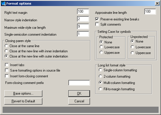

Visual Lisp Editor Settings - are they different from yours?
See the attached image, are my settings different then yours?
Somehow I have the feeling that something has changed, like the lines in between (blank lines)... I don't know... thought I'd ask...
(Never been in this panel though :cry: )
Heeyy ~J~ ,
Long time no see!
Thanks for your "settings": I have set them the same way as you have.
Indeed it looks more familiar to me.
Regards,
Marco.

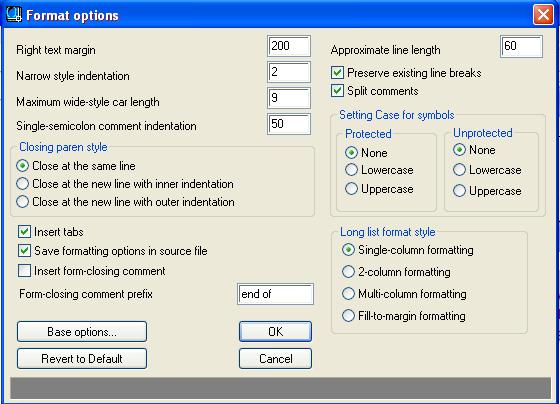

You're welcome, mate
Just a hint:
go to
C:\Documents and Settings\admin\Application Data\Autodesk\AutoCAD 2008\R17.1\enu
and search for 'VLIDE.dsk' file
then save as backup somewhere on your machine, then you can use it if
some fatal error with editor would be occured in the future
~'J'~

Marco if you have loaded a LISP in the VLIDE that has something like this at the bottom:
;|«Visual LISP© Format Options»
(80 2 45 2 nil "end of " 80 70 0 0 0 nil nil nil T)
;*** DO NOT add text below the comment! ***|;
Then your VLIDE settings will be changed in accordance with the settings coded into the above expression.

Mine:
Thanks guys!
@ LEE:
  Quote
That I didn't know, tnx for the explaining!
