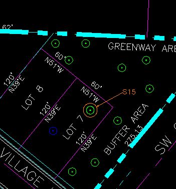

hey car5858, do the lots end up having trees in them?? ive put in the trees to remove and some of them were in the lots but i didnt think anything about it but i started on the trees to save and s15 is in the corner of lot 7. i dont know if i have the lot wrong or something else. ive only got 26 of them in so far.
thanks
joe
I just took a look at the drawing. S 17 in not near the lot.
(1421511.32,783581.92)
Attached is a screen shot of where it should be.
What are your unit settings?
Is your bench mark in the correct location?
Sorry to have miss read your last post, after rereading I see that I thought you were refering to S 17 instead of S 15.
Here is the correct position for S 15 (1421502.96,783650.72)
Make sure you have the unit precision set to max while putting in the trees. (Increases the position accuracy)
thanks buddy. thats where s-15 is on mine also, i guess i was thinking that if they were in the lot they must be to remove.... when i get where i think im getting close to done with it would you take a look at it for me??? i need a good grade on this.
thanks
joe don
Yes I will take a look at the drawing for you. Let me know when you are ready.
Do Not post the drawing, otherwise someone will use it as there own work.
im getting there im stuck now on the part where it says to activate the layer called trim and draw a 24"x36" landscape border for trimming. i didnt make a layer called trim or am i reading into this wrong????
thanks again
joe don
i added a layer called trim and put the trim lines on it unless someone tells me otherwise the only other questions i have is with the row layer. is this the right of ways???? do yall put anything in the title block besides the oleson village title????.
