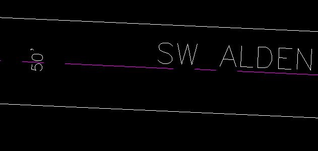

autocad2010 Posted April 27, 2010 Author Posted April 27, 2010 It said: Drafting the Plat Map: Make a north arrow on the map, show center lines on all roads and streets. I think it means center line marker. Then it says: Label all property line bearings, and property line lengths, and all right of way widths. Quote
MikeScott Posted April 27, 2010 Posted April 27, 2010 Yeah, I'd agree with that. Basically, you just OFFSET the edge of the road to it's center, and give it a new layer/linetype. That's only going to work if the width of the road doesn't vary, otherwise you'll just need to draw a line wherever the center is. Of course, I don't know how the streets were initially drawn, and so an offset might not work in your case, regardless. LTSCALE will ensure that the dashes and suchlike, in the linetype, show up at an appropriate scale. I'd look around for examples to determine what linetypes to use for each thing they're asking you to draw. Quote

autocad2010 Posted April 27, 2010 Author Posted April 27, 2010 Yes, I'm a distant student doing the auto cad at Penn drawing the oleson village plat map. You are right, I did make a centerline layer that's already dashed. But the question is how do I make it in the middle of the road? and how to make it turn around the arcs? Quote
ScribbleJ Posted April 27, 2010 Posted April 27, 2010 Typically on plat maps the centerline of a road is the center of the right-of-way. The road usually centers on this same centerline but that is not always the case. In the case of interstate highways, state highways, etc. the centerline of the road can be quite different than the right-of-way centerline. Also centerlines only have arcs in them if the road has a curve. If they intersect with another road then the centerline terminates at the centerline of the road it intersects with. Roadway delineations (ie. painted markings) are not always the center of the road either. Although typically they are. Quote

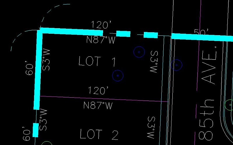

autocad2010 Posted April 27, 2010 Author Posted April 27, 2010 How do I label property line bearings, and property line lengths, and all right of way widths. Quote
ScribbleJ Posted April 27, 2010 Posted April 27, 2010 How do I label property line bearings, and property line lengths, and all right of way widths. You will have to label them manually unless you have Civil 3D or Land Desktop. There maybe a lisp routine lurking on this forum to help automate the labeling. Quote
Car5858 Posted April 27, 2010 Posted April 27, 2010 Here is a screen shot of parts of the drawing. I think this will answer some questions. Quote
autocad2010 Posted April 27, 2010 Author Posted April 27, 2010 This definitely helped!! Thank you my friend. So those small arcs I can make them, and then I would just put the total length of each side on those lots? Or should I use lisp? Also I noticed you placed S3w, do I need to post those as well? Quote
Car5858 Posted April 27, 2010 Posted April 27, 2010 If you use a lisp you will have to redraw the plat map, and the max score you will get is a 75%. I think you haven't read the instructions through. The instructions are out of sequence with the information as givin and the draw order.(This is how your tested to see if you read the instructions) Work the instructions line by line. It will tell you were to put everything. Just make sure your bench Mark and POB are correct. DO NOT change the drawing limits or you will loose points. (I have first hand experiance there.) Quote
