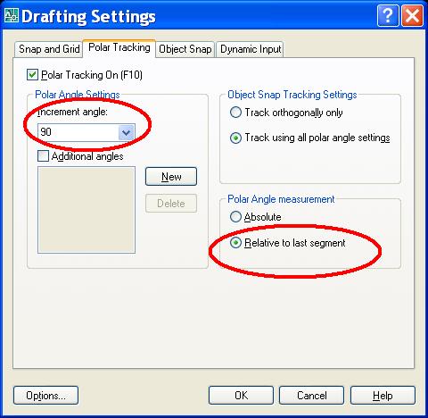

Helo everyone,
Can anyone help me on the drawing?
I need to make a straight from the tangent to the end of the line, or if I begin to the end of line the tangent will be on the end of the given tangent
can anyone help me on this? I appreciate any suggestions
thanks :)

Here's one way...
Set your Polar Tracking settings as shown
Draw a line from the center of the arc to the tangent point; continue the line using the polar tracking snap of 90 degrees
Erase the 1st line and trim the 2nd as needed.

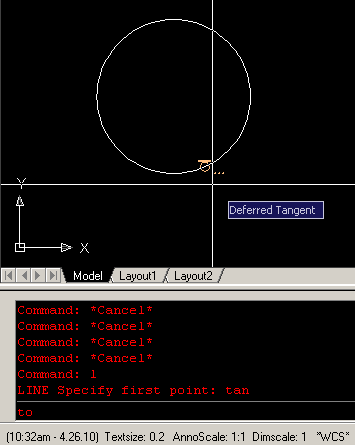

A Line from ENDpoint to TAN (osnaps) won't do it?
A tangent is defined by the other end of the line.. you could literally have a tangent from any point on a circle, but it depends upon your intended direction of travel from/to the circle.
You can also just execute the command then use the tangent osnap override.
eg. If you issue the LINE command, then pick the tangent point on a circle:
