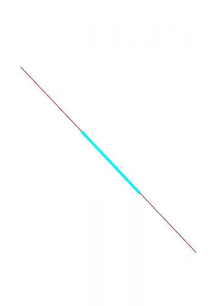

I am attaching an image...
in tat if red line is present..
i want to draw automatically cyan line by click of red line..is it possible
Better yet to start learning Lisp
Anyway give this a shot
Option Explicit
Sub DrawOverPline()
Dim oEnt As AcadEntity
Dim varPt As Variant
Dim oLine As AcadLine
Dim oPline As AcadLWPolyline
Dim copyPline As AcadLWPolyline
Dim cpt As Variant
With ThisDrawing
.Utility.GetEntity oEnt, varPt, vbCr & "   >>   Select pline >>"
If Not TypeOf oEnt Is AcadLWPolyline Then Exit Sub
Set oPline = oEnt
.SetVariable "OSMODE", 2
cpt = .Utility.GetPoint(, vbCr & "   >>  Pick center point of polyline (using snap) >> ")
Set copyPline = oPline.Copy
copyPline.ScaleEntity cpt, 0.5
copyPline.Lineweight = acLnWt050
copyPline.color = acCyan
End With
End Sub
Keep in mind this woul works just with polyline
that has 2 coordinates only as on your drawing
