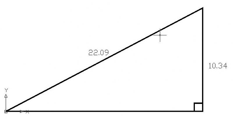

The Buzzard Posted April 23, 2010 Posted April 23, 2010 Hello all, Is there any way possible to get the angles of the right triangle below knowing only the distance of two sides? I went through this once before, But I had a known distance and angle. This is a different situation. Any help would be greatly appreciated. The Buzzard Quote
MikeScott Posted April 23, 2010 Posted April 23, 2010 hypotenuse = 22.09 segment Y = 10.34 Solve for X XX+YY=HH XX + 106.9156 = 487.9681 XX = ? Or.. do it in Autocad.. Draw a line that's 10.34, and then draw a circle whose centerpoint is at the end of that line, and whose radius is 22.09. Then draw a line at 90-degrees from the other end of that line, and wherever it hit's the circle, that's your length. Update: oops.. you wanted the angles. Well, the total of the two missing angles should be 90 degrees when added together.. that much I know.. Here's the rest: http://www.teacherschoice.com.au/maths_library/trigonometry/solve_trig_sss.htm Quote

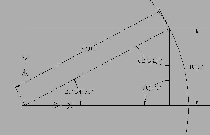

fuccaro Posted April 23, 2010 Posted April 23, 2010 Yes, there is, and you have more ways. 1. Use the arccos function to calculate it 2. make an accurate construction in AutoCAD and put an angular dimension with a lot of decimals for higher precision. once more: I can't type fast enough. MikeScott, you got me. Quote

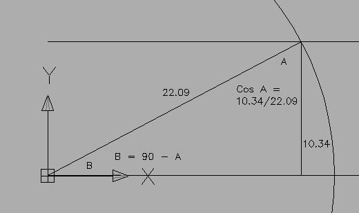

eldon Posted April 23, 2010 Posted April 23, 2010 Or even graphically. Draw a line from 0,0 a distance 25 or so to the right, hozirontally. Then draw a circle of radius 22.09 centered on 0,0. Offset the line 10.34 upwards. Draw a line perpendicular from the original line to the intersection of the offset line and the circle, and then back to 0,0. Angles are there, as in picture Quote

Glen Smith Posted April 23, 2010 Posted April 23, 2010 Any High school geometry student should be able to tell you SO CA TOA Sine(angle) = opposite/hypotenuse Cosine(angle) = adjacent/hypotenuse Tangent(angle) = opposite/adjacent so the angle = arcsine(opposite/hypotenuse) arcsine(10.34/22.09)=27.91deg. See Miss Sydney, despite your crappy teaching, I did learn something, and despite myself, retain it and apply it to the real world. Glen Quote
