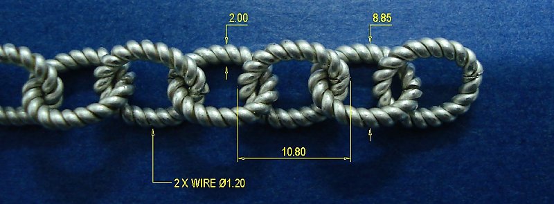

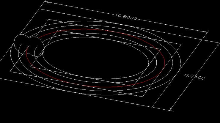

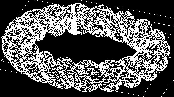

ica_cici Posted April 23, 2010 Posted April 23, 2010 Hi All, I need to make a twist oval solid, it made of two 2 wires D=1.20 and the dimension is 10.80 X 8.85 X 2.00. (see picture sweep) So, I use the sweep command to make this solid. But after sweeping 2 circles object along an ellipse path I got a little bit different result than the real objects. (see picture sweep1) For information the twist angle I used is 3240. Did I have a wrong procedure when sweeping the 2 circles? Thanks for help. sweep_.zip Quote

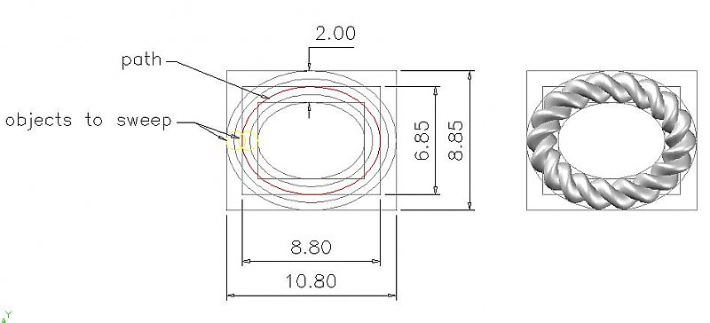

ica_cici Posted April 23, 2010 Author Posted April 23, 2010 Don't know much about Helix command Remark, does it for the path? I'm sorry JD Mather, I forgot to write the information about the path, It's an ellipse size 8.80 X 6.85 and the profiles are 2 circles D=1.20. The target is an oval twist solid (10.80 X 8.85 X 2.00) and here's the history: Command: sweep Current wire frame density: ISOLINES=4 Select objects to sweep: 1 found Select objects to sweep: 1 found, 2 total Select objects to sweep: Select sweep path or [Alignment/Base point/Scale/Twist]: t Enter twist angle or allow banking for a non-planar sweep path [bank]: 3240 Select sweep path or [Alignment/Base point/Scale/Twist]: No, the profiles was not preflattened, MikeScott. Its just 2 circles sweeps to a plain ellipse path. Did I use a wrong path? sweep_.zip Quote

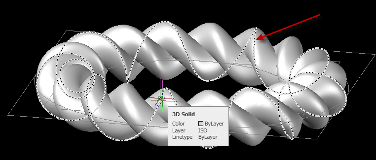

JD Mather Posted April 23, 2010 Posted April 23, 2010 Don't know much about Helix command Remark, does it for the path? Helix command is not going to help in any way as your path is not a helix. I forgot to write the information about the path... OK, I see what you are trying to do now. It is not going to work to twist around an ellipse. If you click on your solid you will see an elliptical "corkscrew" edge highlighted. Your desired path will actually be a curve similar to this. Somewhere I have an Excel spreadsheet formula to create the curve, but now I can't find it. If someone can recall the technical name for a curve of this type perhaps that will jog my memory to find the *.xls The key will be to get the correct math curve for the path at the center of your sweep profile with the profile perpendicular to the path at the start of the sweep. Quote

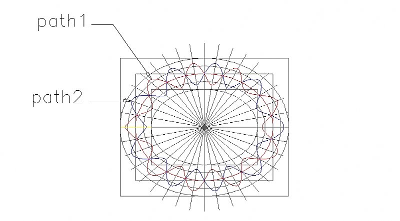

ica_cici Posted April 26, 2010 Author Posted April 26, 2010 ...Somewhere I have an Excel spreadsheet formula to create the curve, but now I can't find it. ...The key will be to get the correct math curve for the path at the center of your sweep profile with the profile perpendicular to the path at the start of the sweep. I know nothing about the Excel formula JD Mather, but I made these two spline paths manually (see the picture). It just trial & error. The problem is I couldn't extrude or sweep the circle profile along the path. Should I trace it by 3dpline? Is there a way to turn a spline into pline? That's lovely SEANT, I tried what you did, but I don't get the same result as yours. I trimmed the two circles and pedit into pline, then sweep it along the ellipse path using twist angle=3240. So something wrong with my procedure I believe. Wow... How did you do that? sweep.dwg Quote
