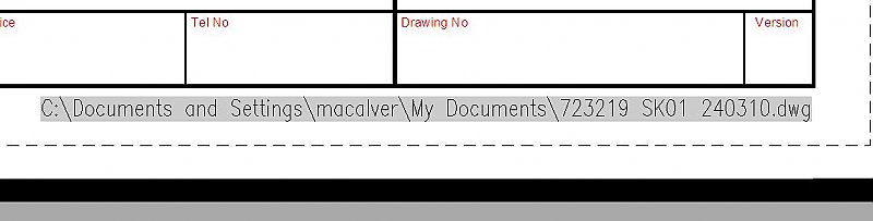

I want to set up an attribute that automatically shows the location of the saved drawing.
An example is shown in the attached file.
Many thanks,
Mark
Sorry, the attached image is here.
a field will do this. Probably best to include this in your drawing blank as a piece of tEXT or MTEXT. Right click while in your text editor and select Insert Field. In the "All" or "Documents" category is the Filename object. This has options for including path & extension.
Having typed all that I notice you are using 2005 - I wasn't aware of fields until after that release in which case you may have to use a diesel expression - which I am not too familiar with.

Worked a treat, thanks very much!

Altough it is in an MTEXT format, it is not possible to have text wrapping, just a long line with the file path.
Update, created the filed.
Then created a field.
Copied the field into the MTEXT and you are able to wrap it so that it covers more than one line.
