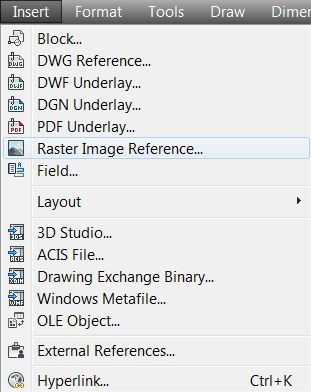

I have a drawing of a logo that is in a jpeg format and I want to either some how trace the logo or insert it into autocad so i can cut this logo out on the plasma table. Any help would be greatly appreciated since I am a newbie to all this.
Thanks:D
Here you go, just follow the command line options.
I can do that but once the image is in there I can not adjust, copy or trace it to arcs and lines for cutting on the cnc table. will I have to do this with the layer application.
What software does your Plasma Cutter use? It may or may not have "Raster to Vector" built in which would do the conversion for you.

I did have some success with this application on a clean pdf. I seem to have had better results using pdf rather than jpg.
Give it a try.
http://www.aidecad.com/
KC
We are using sheetcam. And I am going to try the whole pdf thing now. thanks for the advice and shortcut to the site.
