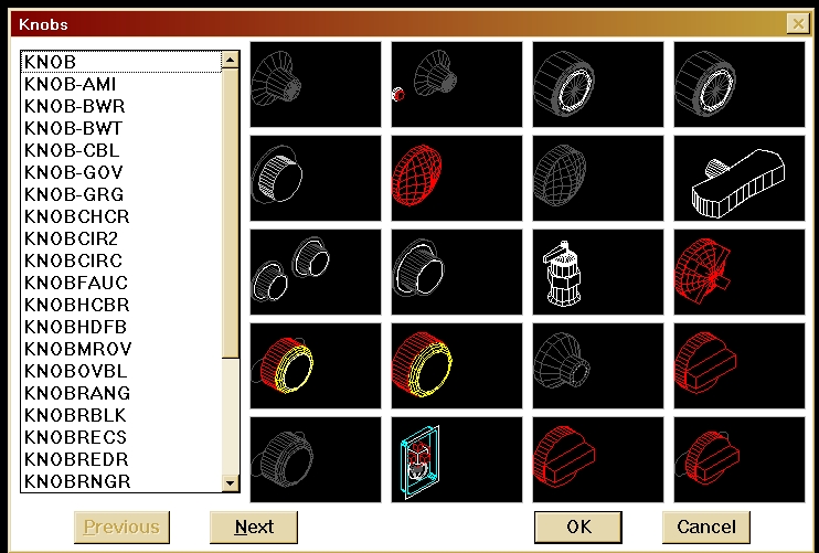

David Bethel Posted April 21, 2010 Posted April 21, 2010 If they are Autocad slide files, they are made with the MSLIDE command. They can viewed using the VSLIDE command. They can also be incorporated into pulled down menus. They have fairly limited uses outside of autocad. -David A menu of knobs I use regularly uses slide images Quote
rkmcswain Posted April 21, 2010 Posted April 21, 2010 Slide files are made using the MSLIDE command in AutoCAD. Tool palette buttons require regular raster images though (.bmp, .jpg, .png, .gif, .tif) Slides were used mainly for the old image menus, an example of which is shown here: http://www.markcad.com/autocad/imagetilemenu.gif Quote
