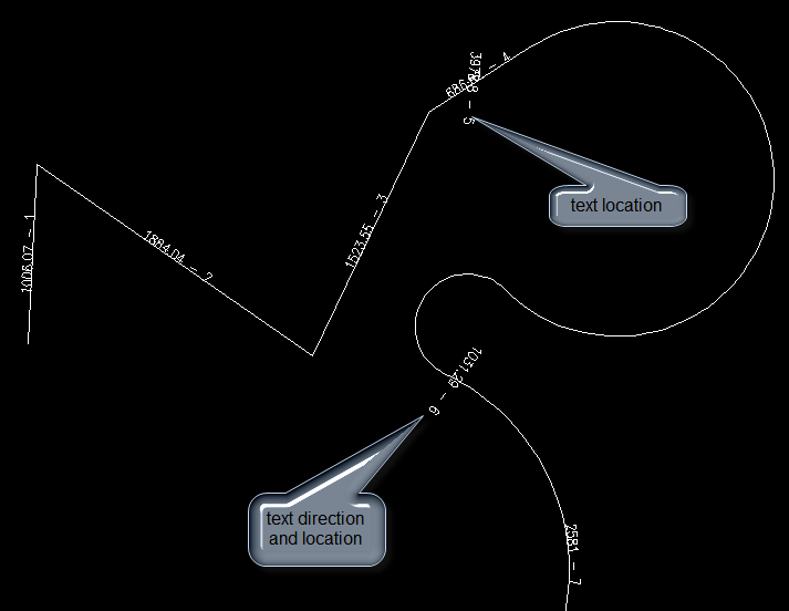

Hey Lee Mac, thanks for the lisp. It's almost what I need. Concerning the autonumbering and alignment it's perfect but I still miss the length of the polyline.
See image for more info.
Again thanks for the help.

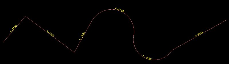

Give this a shot, it uses Fields:

I guess I read the request wrong. I was thinking the ability to label each segment length was the desired result. Oh well, it was fun to put together and I might have a use for it (minus the numbering).
Good stuff Lee.:)
Lee, it's awesome!! That's exactly what I was looking for.
Thanks!
You're welcome :)
I like to use the dynamic approach when placing text, as it gives you a proper preview of what you are about to place. The only drawback to this method is that you don't have any AutoCAD functionality such as OSnap, Ortho, Tracking etc. But I figure most do not use such that regularly to place text.
Lee
Alanjt
see attached image and cad file
Ahh, the woes of vlax-curve-getClosestPointTo and not properly considering it's obvious constraints.
Try it now (also removed the need for the AT:MText subroutine since I was defining the ActiveSpace for each text object.
(defun c:PLab (/ obj)
 ;; Label each LWPolyline segment with number and distance
 ;; Alan J. Thompson, 04.21.10 / 04.23.10
 (vl-load-com)
 (if (and (setq obj (car (entsel "\nSelect LWPolyline: ")))
          (or (eq "LWPOLYLINE" (cdr (assoc 0 (entget obj))))
              (alert "Invalid object!")
          (setq obj (vlax-ename->vla-object obj))
   ((lambda (n l s / d)
      (while (nth (1+ (setq n (1+ n))) l)
        ((lambda (a b / dist)
           (setq dist (abs (- (setq d (vlax-curve-getDistAtPoint obj a))
                              (vlax-curve-getDistAtPoint obj b)
           ((lambda (p)
              ((lambda (text)
                 (vla-put-AttachmentPoint text
                 (vla-put-InsertionPoint text p)
                 ;; (vla-put-Rotation text (angle a b))
                 ((lambda (ang)
                    (if (and (> ang (* pi 0.5)) (< ang (* pi 1.5)))
                      (vla-put-rotation text (+ pi ang))
                      (vla-put-rotation text ang)
                   (angle a b)
                (vla-AddMText s p 0. (strcat (itoa (1+ n)) " - " (rtos dist)))
             (vlax-3d-point (vlax-curve-getPointAtDist obj (+ (/ dist 2.) d)))
