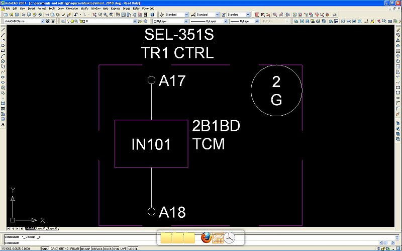

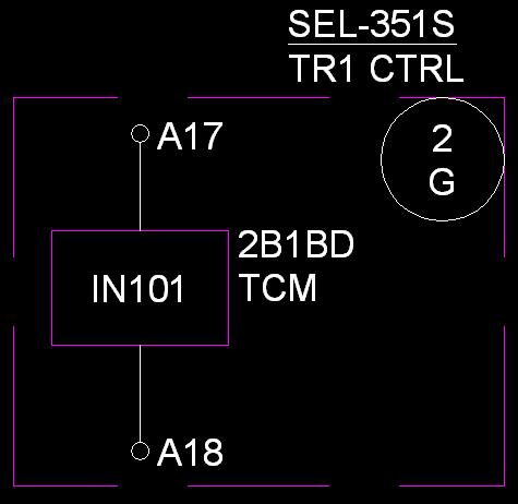

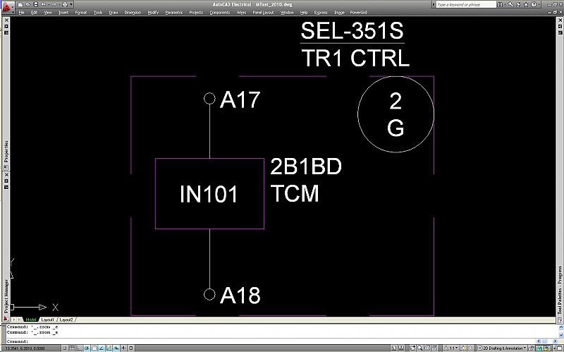

I am not sure why this is happening or what I can do to fix it but I am having an issue with MText between AutoCAD 2007 and 2009. My issue is when I create MText in 2009 and set its justification through the properties, the text will come in shifted using 2007.
The examples I have attached were all opened and saved in AutoCAD 2007, 2009, or 2010 to show what it looks like in each. As you can see, the MText on top of the dashed box is shifted in 2007 to the left more so than it is in 2009 or 2010.
Can someone shed some light on this for me?
**Edit**Sorry images came in different than expected. Top Left is viewed from 2010, Top Right from 2009, and bottom from 2007.

In order for you to see the shift, you have to open it in 2009, look at it there, then open the same drawing in 2007, and in 2007 it will look shifted over to the left. If you open each drawing in the same version of AutoCAD they will look exactly alike, because they are exactly alike. There should be no difference between the drawings because all I did was copy and past this image into each version of AutoCAD, 2007, 2009, 2010, and just save them with different names.
In the screen shots I provided, you can see the shift. Same drawing in each case, but in 2007 the MText shifts over to the left.

Here is a better view of the difference I am seeing. This is the identical file opened in AutoCAD 2010, and 2007.

I hear what you are saying. I have tried using text styles that both 2007 and 2009 recognize but end up with the same result. I really believe it has to do with the way the two different version recognize the justification because if you open the file in 2009 and then in 2007 you can see that the justification grip point is actually in a different location in both.
I think I may have found the problem...
If you open the drawing and double click the MText on top of the dashed box to edit it, the width ruler is not expanded out. After I expand it out, and save it like that, it does not shift positions in any of the versions of AutoCAD.
Anyone know why this is? It works but why??

you get that tape measure when the width has been set on the text.. Otherwise it's written as "zero" and there's no tape measure.
If you select the dimensions giving you trouble, you could then use the properties window to fix that by manually changing the width property.
