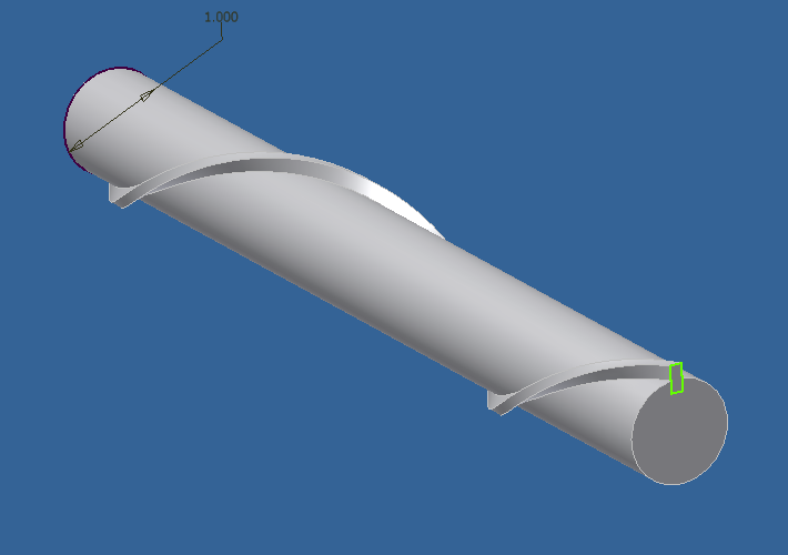

kencaz Posted April 20, 2010 Posted April 20, 2010 make your brush profile perp to your cylinder and sweep. KC Quote

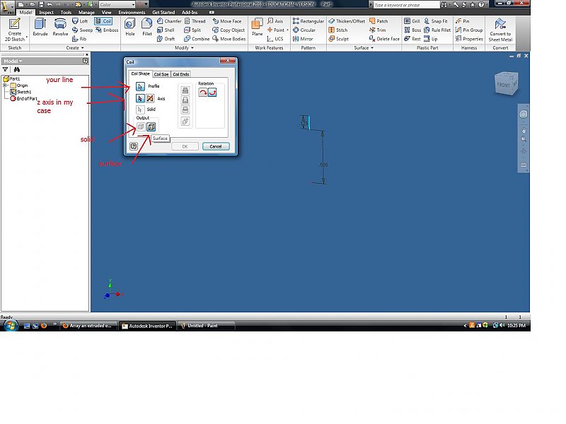

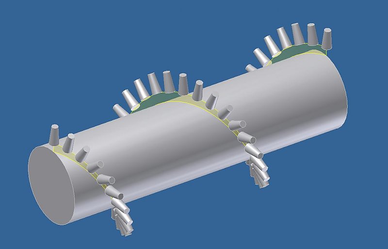

shift1313 Posted April 20, 2010 Posted April 20, 2010 instead of sweeping a solid with the coil operation I would use a single line and make a surface. Then you can draw a single brush, use linear pattern and for Direction1 select the edge of your surface. Make sure you expand the options and change Compute to Adjust and Orientation to Direction1. I did this in an older version but in 2010 you will also have the option to make each brush a new part or merge them with the roller. This one i did a simple cone but your brush could be more detailed. edit. my surface is above the roller only so you can see it. the surfce could be within the roller. If i were to model a part like this i would array a Hole, then add the brush in an assembly. Quote

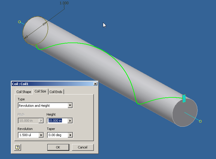

Archetype Posted April 21, 2010 Author Posted April 21, 2010 instead of sweeping a solid with the coil operation I would use a single line and make a surface. Then you can draw a single brush, use linear pattern and for Direction1 select the edge of your surface. Make sure you expand the options and change Compute to Adjust and Orientation to Direction1. I did this in an older version but in 2010 you will also have the option to make each brush a new part or merge them with the roller. This one i did a simple cone but your brush could be more detailed. edit. my surface is above the roller only so you can see it. the surfce could be within the roller. If i were to model a part like this i would array a Hole, then add the brush in an assembly. -------- Ok, I have the helical line withing my cylinder but i'm stuck on how to create a surface from the line so that i may finish the sketch as you did. I am not allowed to extrude the line at all, i thought that's how i would create the surface. Little help? Thanks, Quote
JD Mather Posted April 21, 2010 Posted April 21, 2010 -----I am not allowed to extrude the line at all, i thought that's how i would create the surface. Little help? Thanks, Coil You might want to go through this document http://home.pct.edu/~jmather/AU2007/MA105-1L%20Mather.pdf Can you attach your file here? Quote
shift1313 Posted April 21, 2010 Posted April 21, 2010 On the coil pop up you have the choice to make a solid or surface. If the line is the only thing you have, surface will be all you can do. If you have any closed sketches you will have to manually select Surface. Quote

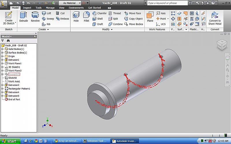

Archetype Posted April 21, 2010 Author Posted April 21, 2010 Thanks All! I am a rookie at Inventor but with your help i was able to achieve what i set out to do. Maybe not the most efficient way but I'll get better as I go. I decided to array the holes as suggested and put the brushes in the final assembly (great idea!) I'm sure I'll be back for more assistance in the future. Results attached... Thanks again! Quote
