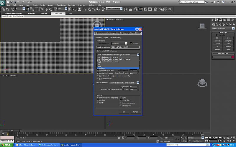

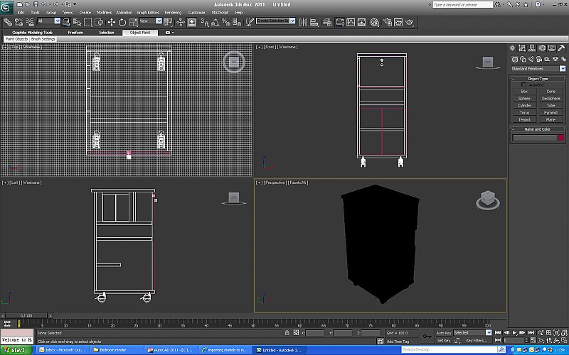

Ive come across this problem all of a sudden when importing models from cad to max 2011, When i used to import models the model was a grey colour and when i put lights into the drawing they would show up but now when i import something the model is black and no lights show up..... its driving me mad, any ideas whats happened to it and what i need to do to fix it??

Ive attatched an image of what i mean about the black model

cheers cad64, just this min figured out what was up, i had one of the settings in the import section wrong
oh no maybe not, its not showing the lights in the drawing??!! would you do me a favour and have a look at which one of these in the drop down menu in the import screen are checked on yours??
Note: I don't work in Metric units, so my settings below will have to be converted if you want to compare them to yours.
It depends on what I'm Importing. I might choose Layer, Color, Entity or sometimes One Object.
I also typically have "Weld Vertices" checked, with a setting of .01, and "Auto Smooth" checked with a setting of 15.0.
I set "Curve Steps" to 10 and "Max Surface Deviation" to .01 or lower depending on how smooth I need the model to be.
The "Include" options just refers to the CAD file and how much of it you want to import. It's pretty self explanatory.
But no matter which options you choose, you should not get a black model, and you should be able to insert lights, so I'm not sure what's going on? Have you tried Importing the CAD model into a new file?

Try adjusting your settings under "Derive AutoCAD Primitives by" to be "Layer, Blocks as Node Hierarchy"
I had Split by Material and it was all black for me too. I switched off of Spit by Material and now works fine.
Apparently it's all black until I assign some kind of material. I don't know why, and I'm pretty sure it wasn't like this in max 2010. But I got it working now :)

It's not a "cause", it's a preset:
When loading the acad file in Max 2011 and the pop up appears, there's a pull down called "Presets". Select the one for AutoCAD or whichever Autodesk software you are using. Attach file.
BOOM! No more black perspective. At least not for me.
