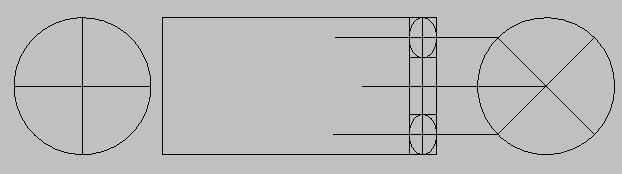

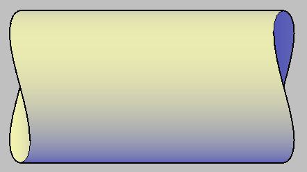

Trugga Posted April 19, 2010 Posted April 19, 2010 Greetings all first post. Appologies for the message title, but hopefully it is descriptive enough. On occasions, I need to show a cut in a length of steel bar (or tube) in a 2D drawing. If I were to draw it by hand, I'd do it like this: (OK, so that is actually a 3D model of a 100mm dia bar with a 200mm dial bar subtracted from it and then rotated 45 deg) Using AutoCAD 2010, I can only get this far I've tried various hit-and-miss attempts with "spline", but I'm sure there must be a logical or mathamatical way to complete the loop. Any help greatly appreciated. Lawrence Quote
JD Mather Posted April 19, 2010 Posted April 19, 2010 Most drafting books cover a simplifed method of drawing this break. Do not try to exaclty duplicate the results from a 3D model. A couple of moves, mirrors and tangent tangent tangent for the fillet and trim it up. Cylinder Break.dwg Quote
stevsmith Posted April 19, 2010 Posted April 19, 2010 I basically draw 2 ellipses on the end and trim away the the inside of one ellipse then mirror to the opposite side. There should be no need to make things that complicated. Quote
Trugga Posted April 20, 2010 Author Posted April 20, 2010 You are attempting this in 2D right? Yes Cheers JD - your example does give a fair representation. I think with a combination of JD's example and the ellipses I should get a consistant and reasonable result. I did wonder if there was some form of logic involved (like the development of a truncated cone), but perhaps just for a break point it does not really matter. Cheers guys Lawrence Quote
stevsmith Posted April 20, 2010 Posted April 20, 2010 That just seems like alot of excess drawing to me. Cylinder Break rev a.dwg Quote

Eatonpcat Posted April 20, 2010 Posted April 20, 2010 I basically draw 2 ellipses on the end and trim away the the inside of one ellipse then mirror to the opposite side.There should be no need to make things that complicated. We have a winner... Simple as this!!! Quote
