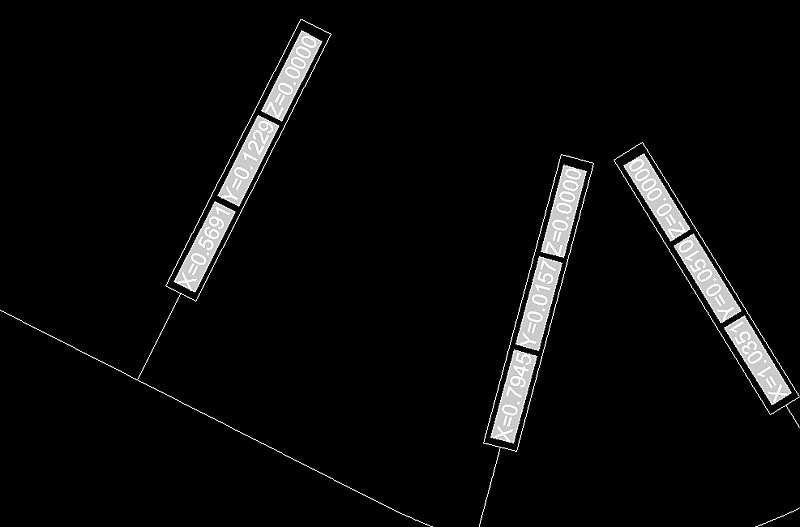

Hi,
my previous "Perpendicular on Given Polyline with given segment " is solved.
but I want to trying to show Coordinates above these lines also (Picture as Attached).
Lines are same Length, Text covered by a box(rectangle) and Line,text & box are different colors.
if this can solved by Excel, may be it's much better.
have any solution for this.
Many Thanks and Regards,
—Sam

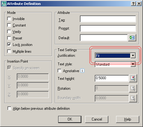

You would have to use a Dynamic block with stretch or attributes with textfit option.

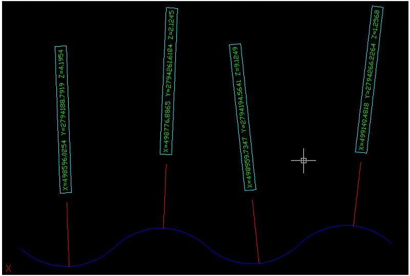

Thanks for this coordination but in this tip we resize our text. means, if text Value is short (b'cos I ignore trailing Zero from coordinate) than the block showing more wide text and if value is long than block text wideness is reduced.
but I need fixed height & Width TEXT.
in Dimension Style there is a Check Box Option, say "Draw Frame Around Text" ( under TEXT APPEARANCE IN TEXT TAB)
how this function works
if possible can u have any idea for lisp code for Attributed block Dialog Box with merging "Draw Frame Around Text" Option.
