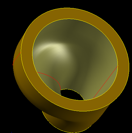

srinu_vasu38 Posted April 17, 2010 Posted April 17, 2010 Thank u very much regarding reply to my thread. but i am unable to draw eccentric reducer using the enclosed sketch. Please help me sir. eccentric reducer.dwg Quote

ReMark Posted April 17, 2010 Posted April 17, 2010 I would recommend using the LOFT command. For example, to LOFT the OD of the eccentric reducer first pick the larger of the two pipe OD's then the smaller. AutoCAD will prompt: Select cross sections in lofting order: It will respond with each pick: 1 found and it will tell you the total selected: 2 total. The next AutoCAD prompt will be: Enter an option [Guides/Path/Cross sections only] : Your response should be to type the letter G for Guides then press Enter. AutoCAD will prompt you to Select the guide curves: It will tell you how many are found and the total. The "guide curves" in this case will be the combo straight/arc lines on the left and the one straight line on the right. AutoCAD will then create a LOFT between the two circles using these guide lines as a kind of restraint. Do this for the OD and the ID of the reducer. SUBTRACT the ID from the OD and you're done. Addendum: I think you will have to offset/copy the OD guide curves a distance of 12 units to create guide curves for the ID. Quote
ReMark Posted April 17, 2010 Posted April 17, 2010 I had a little trouble working with your drawing so I had to redraw portions of it. I also created two new layers, one for the reducer OD and one for the reducer ID. I changed some line colors too for purposes of clarity. I did one other thing too and that was to combine the arc segments and straight lines you had on the left (shown in red) using the Pedit command. Here is the result of my efforts which proves it can be done. Now, it is your turn. Quote
JD Mather Posted April 17, 2010 Posted April 17, 2010 The complex guide curve you have on one side must be a joined polyline. I then tried Shell but the part would not shell. So as Remark indicated you will also need to offset the guide curves 12 towards the inside and do a second Loft and the Subtract. You might want to do the tutorials in my signature or type Loft hit Enter and then hit F1. Looks like ReMark gave you then step-by-step while I was typing. Quote

JD Mather Posted April 17, 2010 Posted April 17, 2010 Actually I should have said, "it would shell at a thickness of 6 but not 12, so like you did, I used two lofts and then subtract. I also increased facetres to max 10. And like you did, I created additional layers to help control the flow of the work, especially if editing will be needed. Quote
