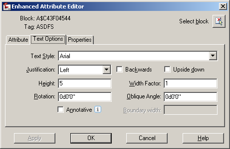

Is there any way to change the text size and font in the Detail bubble???? :huh:
You can scale the multileader, or you can use the block Detail Callout as a starting point and edit it to use a larger Text Style and circle, save it as MyDetailCallout or whatever.
You can then build a new Mleader Style with it.
It will appear in the Source Block dropdown list under User Block -> selection list.
Alright, I know there is a "Right Way" to do it. Somebody will tell us.:wink:
In the attribute editor (just double click on the attributed block / attribute), you can change the properties from there.
eg.
eg.
[ATTACH]18895[/ATTACH]

Wait. Is that something that ACAD LT cannot do?:shock:
My Attedit only gives me a select cursor, and for me to select the Detail Callout block, the leader has to be exploded. It then only lets me change the content of the text, not its size or anything else.
Type DDEdit (or just type ED). Can't vouche for LT options, though.

Nope, with DDedit, and Edit, only difference is I don't have to explode the multileader because those will edit Annotation objects.
I guess I will have to break open my Harley Jar and see if there's enough quarters in there to buy me an upgrade to Full ACAD.

Oh, I didn't realize they were within a multileader (I'm retarded). That editor doesn't work on Multileaders.

I will have to try the attedit command on some other blocks.
