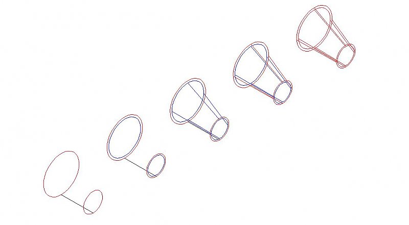

A simple eccentric reducer in 3D. The commands used were circle, offset, loft and subtract.
Pictured below is a 4x2 eccentric reducer. The color red = O.D. The color blue = I.D.
Read from left to right.
First set of objects depicts both O.D.'s.
Second set of objects we offset for wall thickness to get the I.D.'s. Third set of objects we loft the two I.D.'s.
Fourth set of objects we loft the O.D.'s.
Fifth set of objects we have subtracted the I.D. from the O.D. Done.
Visual style = 2D wireframe.

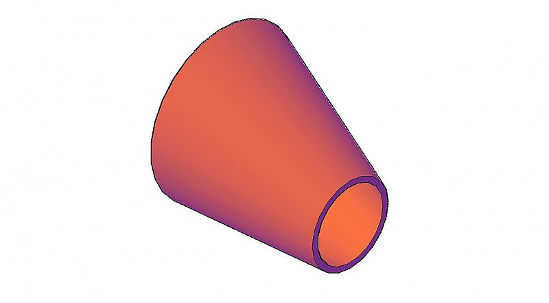

Finished eccentric reducer shown using Conceptual visual style.
