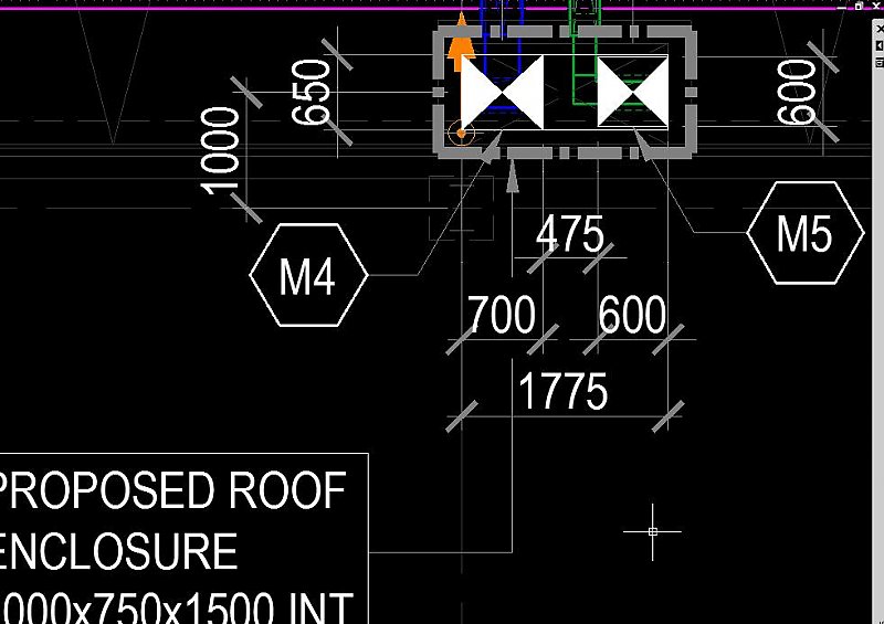

VisDak Posted April 15, 2010 Share Posted April 15, 2010 Hi all, Good day i just notice about leaders clashes on other text or dimension, is it possible to break a leader by not xploding or creating an extension line, (on dimension we can break by using dimbreak but on leader we dont have) is this possible to break the leader similar with dimension by creating route? kindly see image for sample drawings, hopefully it can be done many thanks Quote Link to comment Share on other sites More sharing options...
BearDyugin Posted April 15, 2010 Share Posted April 15, 2010 Mtext: Properties -> Text -> Hide the background -> Yes Dimension: Properties -> Text -> Fill Color -> Background Text: Express Tools -> command textmask Everything else: command _wipeout translation may not be accurate Quote Link to comment Share on other sites More sharing options...
lpseifert Posted April 15, 2010 Share Posted April 15, 2010 You can use Dimbreak with a Multileader. Quote Link to comment Share on other sites More sharing options...

ILoveMadoka Posted April 16, 2010 Share Posted April 16, 2010 Can you change the size of the break gap? I'll ask here first before starting a new thread... TIA!! Quote Link to comment Share on other sites More sharing options...
ILoveMadoka Posted April 16, 2010 Share Posted April 16, 2010 Nevermind.... I guess the internet is not just for porn anymore!! That d@mn Google!! Dimstyle -> Symbols and Arrows Tab -> Lower Left Corner!! Quote Link to comment Share on other sites More sharing options...
