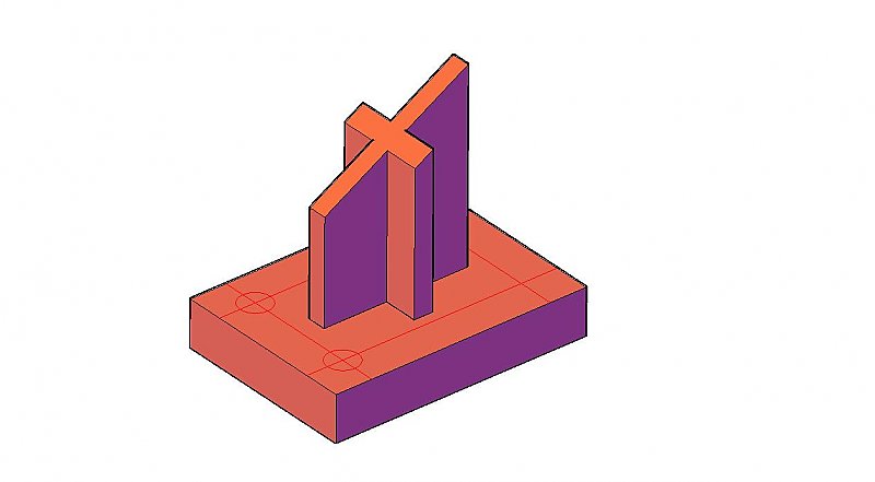

I am trying to pull a cross shaped region up to a slanted mounting brace, but when I do it, it won't stop along the slant. It protrudes through and beyond the solid brace.
I tried moving my UCS to the top of the line aligned with the slanted solid on the top. Any suggestions?

Press/Pull or Extrude and then use the Slice command might be one option.

Is this the affect you're looking for?
There is another way to do it too.

Hi ReMark, I don't know if you remember me, but you were very helpful in my last Cad class. The result I want is what you showed, and I did get it using the slice command, but I was wondering if there was just a one step procedure using presspull, or something else. Maybe I could have gone about drawing the object differently to start, and then I wouldn't have this issue!

One step? Hmmm....I'm not sure. None I can think of at the moment. I'll have to look into it.
I'm glad to hear however that you did get the end result you were looking for.

Solidedit>Faces>(Taper or Rotate) would be another method.
You could also start with a wedge and modify that.
