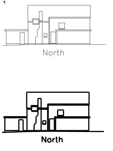

dbroada Posted April 13, 2010 Posted April 13, 2010 I have a need to WMF some drawings. Is it possible to do this in B&W? I don't really want to explode all the blocks just to change their colours. Quote
NBC Posted April 13, 2010 Posted April 13, 2010 Can you do WMFOUT as per normal; then open them in Paint, invert the colours via File>Image>Invert Colours, then change the colours in File>Image>Attributes>Colors to be Black & White? Quote
phobos Posted April 13, 2010 Posted April 13, 2010 this is not an autocad solution but usually what I do is - if I am inserting these wmf files in office files-, after inserting the image using the picture tools in office programs. for me this is the easiest way that I know. Quote
dbroada Posted April 13, 2010 Author Posted April 13, 2010 Thanks both, Unfortunately (unless I'm doing something wrong) opening with paint reduces the resolution to an unusable point. These images are not being used in an office document, they form the graphical part of a wiring information package with no graphic editing ability. Quote
eldon Posted April 13, 2010 Posted April 13, 2010 How about making a workaround? Open the drawing, and explode any block which has components that are not coloured Bylayer, change all the layer colours to black/white, export the WMF, then exit the drawing without saving. That way your blocks are not irrecoverably exploded Quote
dbroada Posted April 13, 2010 Author Posted April 13, 2010 that is what I will probably end up doing but several blocks are within other blocks to several layers deep. If I feel like it tomorrow I may look at a VBA solution. You can tell we're not that busy at the moment. Quote
Tankman Posted April 13, 2010 Posted April 13, 2010 Print to a *.pdf using the monochrome.ctb pen. Open the *.pdf and save as. The resulting *.pdf can then be saved in numerous image file types. I'm using Adobe Pro 8. Quote
dbroada Posted April 14, 2010 Author Posted April 14, 2010 with no inbuilt commands available and me not having Adobe Pro I wrote this little VBA routine.... Public Sub Check_Blocks() Dim myBlocks As AcadBlocks Dim myBlock As AcadBlock Dim myBlockReference As AcadBlockReference Set myBlocks = ThisDrawing.Blocks For Each Item In myBlocks If Left$(Item.Name, 1) <> "*" Then Set myBlock = Item Debug.Print Item.Name If myBlock.Count <> 0 Then Call SetColour(myBlock) End If Next End Sub Public Sub SetColour(myBlock As AcadBlock) Dim myLayer As AcadLayer For Each Item In myBlock Item.color = acByLayer If ThisDrawing.Layers(Item.Layer).Freeze = False Then Item.Layer = "0" Next End Sub I have just updated this to put everything on layer 0 except items already on a frozen layer. which changes all but coloured attributes and dimensions to "byLayer". Using the Properties Palette gets most of the way to what I wanted to achieve. Shame I forgot the final output from the wiring diagram routine is to print in B&W so I need not really bothered. It may come in handy some day though. Quote
eldon Posted April 14, 2010 Posted April 14, 2010 When you have your WMF, if it is to be inserted into a Word document, sometimes the line thicknesses can be spindly. In Word you can Ungroup the inserted image, and then apply Line Style (Word's equivalent of line thickness). Quote
Tankman Posted April 14, 2010 Posted April 14, 2010 eldon said: When you have your WMF, if it is to be inserted into a Word document, sometimes the line thicknesses can be spindly. In Word you can Ungroup the inserted image, and then apply Line Style (Word's equivalent of line thickness). If the drawing was saved monochrome, as a *.pdf. The *.pdf can be saved as an MS Word document using Adobe Pro. Quote
eldon Posted April 14, 2010 Posted April 14, 2010 Tankman said: If the drawing was saved monochrome, as a *.pdf. The *.pdf can be saved as an MS Word document using Adobe Pro. Not having Adobe Pro, I was wondering if you had any control over line thickness Quote
Tankman Posted April 14, 2010 Posted April 14, 2010 Not great but, decent enough. I printed to a *.pdf tried to save as MS Word *.doc, didn't work too well. I saved the *.pdf as a *.jpg and inserted into an MS Word file, worked excellent. Below is a super sized down *.jpg image from paperspace. I downsized the *.pdf is MS Paint, don't have a need for PhotoShop although I hear good stuff 'bout the program. Quote
eldon Posted April 14, 2010 Posted April 14, 2010 Tankman said: Not great but, decent enough. I printed to a *.pdf tried to save as MS Word *.doc, didn't work too well. I saved the *.pdf as a *.jpg and inserted into an MS Word file. Your method is raster based, so the line thickness has to be preset. The WMF method is vector based, and thus has line thickness control in the final document, and set to suit. Anyway, two different approaches for the OP. Quote
eldon Posted April 14, 2010 Posted April 14, 2010 I thought that a picture might help. The top picture is with a line thickness of ¾pt, and the bottom picture is with a line thickness of 4½pt (rather excessive but shows what you can do) Quote
