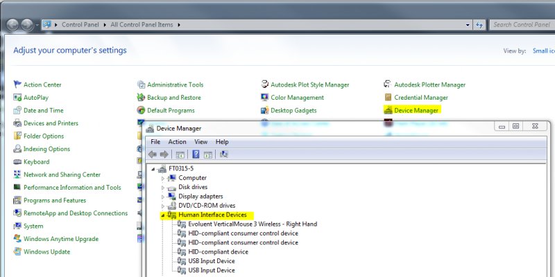

kfonsy Posted January 19, 2016 Posted January 19, 2016 Could not find an uninstall in the control panel/Programs/Hardware for the microsoft mouse. They are usually just plug & play. The Logitech is my third mouse. All because of the same problem. The middle pan or scroll button giving problems. This previous mouse was a Microsoft 1000 combo with a Microsoft wireless Keyboard 800. The pan worked but the zoom/scroll kept slipping. So initially when I bought the new logitech mouse, kept using the same keyboard & switched of the microsoft mouse, connected the new logitech mouse and it was working till now. Quote
RobDraw Posted January 19, 2016 Posted January 19, 2016 Could not find an uninstall in the control panel/Programs/Hardware for the microsoft mouse. It's in the device manager. Quote
kfonsy Posted January 19, 2016 Posted January 19, 2016 Thanks, but if I uninstall it then wont the keyboard will stop working cos both the original keyboard and mouse were on one USB. The logitech mouse works separately with its own USB. Tried unplugging the keyboard USB. Gave it a shot didnt work. Quote
RobDraw Posted January 19, 2016 Posted January 19, 2016 I don't know. You should try all you can to make the Logitech mouse current or SetPoint settings won't work. Quote
kfonsy Posted January 19, 2016 Posted January 19, 2016 uninstalled the mouse, re installed the setpoint software, still no difference. Quote
RobDraw Posted January 19, 2016 Posted January 19, 2016 uninstalled the mouse Microsoft 1000? re installed the setpoint software, still no difference. Did you try the mouse before re-installing SetPoint? I've had several Logitech mice and have not needed the software. Quote
