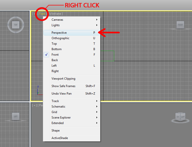

nowikovs12 Posted April 11, 2010 Posted April 11, 2010 Hi I set up a camera in perspective viewport, and changed parameters for the camera, to make it look more dramatic, I deleted the camera, and the view still remains the same, and it is hard to work like that, does anyone knows how to reset viewports or change the perspective viewport to how it was originally? thanks Quote
Cad64 Posted April 11, 2010 Posted April 11, 2010 If you deleted the camera then the view should have reverted back to Perspective. I don't see how it could still remain in camera view if the camera does not exist? But, if you want to change the view in a viewport, right click on the view name in the upper left corner of the viewport and then select the view you want from the pop up menu. Or just hit the key on your keyboard that corresponds with the view you want, such as "P" for Perspective or "F" for Front or "L" for left, etc. Quote
nowikovs12 Posted April 11, 2010 Author Posted April 11, 2010 Hi, that is strange, when I delete the camera it remais in that sharp angle view, and when I rotate the model its hard to understand, because the perspective looks very stretched, the only way I managed to get close to normal perspective view, is to make a nother camera, select "Dolly Camera" and zoom the lens around, so I get the perspective more or less correct, or maybe I am not deleting the camera correctly, I use fn + backspace on mac keyboard as I use normally when deleting all the items, yes, I use those shortcuts, fast and easy, I also tried the plus button, when looked how reset the perspective view, and under + >view cube>reset front, you can only reset the front viewport, any suggestions? Quote

nowikovs12 Posted April 11, 2010 Author Posted April 11, 2010 I think I find the problem, I created a camera in perspective viewport, and made the view very dramatic again, then deleted the camera, nothing happened the viewport remained dramatic, then I changed the viewport to front view, and changed it immediately to perspective again, and it is now normal, so for me, when I delete the camera the view doesn't changes immediately, I don't know why, and is it suppose to change immediately? Unless I have different settings, for viewports,... Quote
