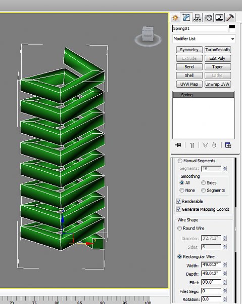

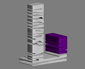

anndrenaline Posted April 11, 2010 Posted April 11, 2010 Im currently using 3ds max 9 and new in it. Im stuck thinking what to do next. I was wondering whats the easiest method to get this spiral like path from what i have so far? convert it to editable poly, splines etc? Quote

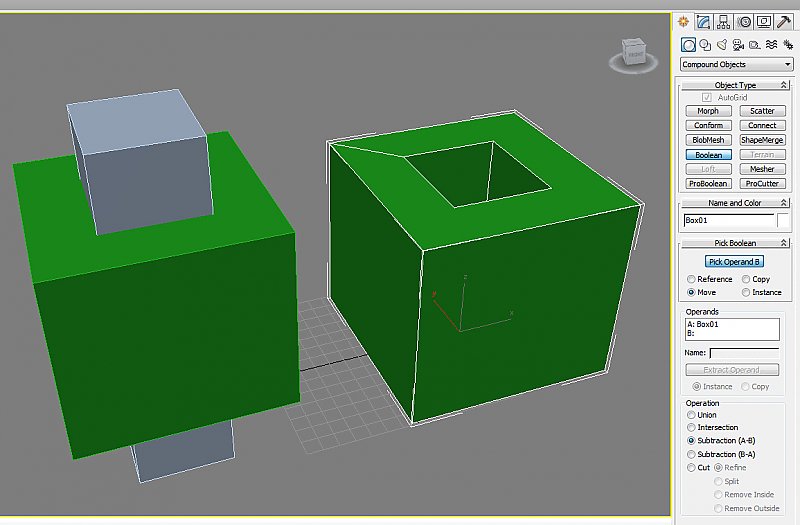

Cad64 Posted April 11, 2010 Posted April 11, 2010 That's going to be a little tricky to explain, but the first thing you need to do is cut a square hole through the center, so yes, convert to editable poly. Here's one way to get started on this project: 1. Create a box that extends all the way through the center of your spiral object. 2. Select the spiral object 3. In the "Create" menu select "Compound Objects" 4. Click the "Boolean" button 5. Click the "Pick Operand B" button 6. Select the box that runs through the center of the spiral object 7. Convert to editable poly Boolean can be a messy procedure sometimes, and you might end up with a lot of cleanup work, but it's worth a try. I generally make a copy of the object I'm going to Boolean, so if it doesn't give me what I want, I can just delete it and I still have my original object intact. Quote

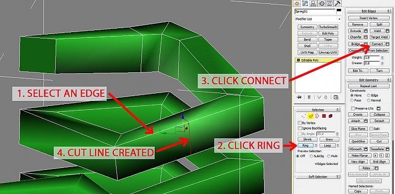

Cad64 Posted April 11, 2010 Posted April 11, 2010 anndrenaline said: what are the modifiers that u think would be suitable to refine the shape. This is where it gets very difficult to explain. You really need to watch some training DVD's or get a good beginners book so you can learn the basics of poly modeling in Max. There are so many modifiers and techniques and procedures that it would be impossible for me to try and explain all of them and how they all work and how you would use them on this model. Also, I use Max 2010, so some of the tools and procedures I use are not available in Max 9. Basically what you need to do is start adding resolution to the model by adding in cut lines and then start pushing the vertices around until you get the shape you want. To add a cut line, select an edge, hit the "Ring" button and then click "Connect". You can add multiple cut lines by clicking the little button next to the "Connect" button and then input the number of cut lines you require. Quote

anndrenaline Posted April 15, 2010 Author Posted April 15, 2010 The rectangular wire spring can only be created as a squarish form, same dimension for all sides but i need it to be in rectangular as in the pictures. Quote
Cad64 Posted April 15, 2010 Posted April 15, 2010 You can make it rectangular. There is a "Width" and a "Depth" option that you can control. You can see those options in one of the screenshots I posted previously. But regardless, the spring will only give you a basic shape. It's up to you to push and pull the vertices to create the proper shape of model. You can't just push a button and have the program do it for you. Have you looked into getting yourself a book or some training DVD's as I suggested. Max is a very complex and deep program. It will be very difficult for you to learn simply by asking questions here in the forum. You need to learn the basics, and in my opinion, the best way is by watching someone else do it. That's why I always recommend DVD training. Quote
anndrenaline Posted April 15, 2010 Author Posted April 15, 2010 It changes in terms of elevation but not plan Since this is for an assignment i need to get the answers directly for the time being due to the lack of time. But i'll watch some video tutorials during some spare time Quote
Cad64 Posted April 15, 2010 Posted April 15, 2010 I can adjust the rectangular spring in both plan and elevation. but then again, I'm using Max 2010, although I think the same options were available in Max 9. Can you post a screenshot of your spring options in the Modify panel? You should have a "Depth" and a "Width" adjustment. Quote
anndrenaline Posted April 16, 2010 Author Posted April 16, 2010 I used back the old method, the screenshot that i posted. Drew out lines on the object in autocad, extrude then subtract. Painstaking task but i find it easier to draw lines in autocad. After subtracting them all I would then have to pull or cut out a part of the objects to connect it to another one in 3ds max since autocad does no justice in terms of deforming and ucs stuff. Quote
