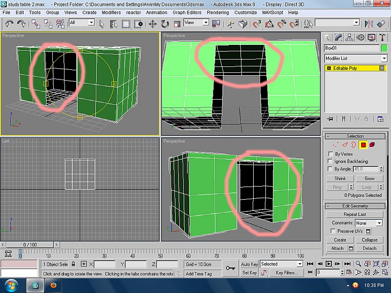

hi guys is it possible to cap the following areas?
You can't Cap open areas, but you can switch to "Edge" selection mode, Ctrl+click on two edges that are opposite each other and then hit the "Bridge" button. This will create a new polygon between the two edges you selected.
