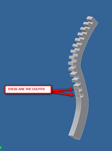

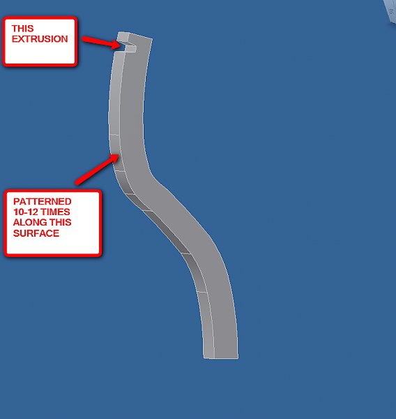

Hello Folks,
As seen in the attached pic, I am trying to Pattern the cut/extrusion along the front surface of this "thing". I've looked in J.D.'s MA105-1 tutorial manual and have tried various different methods without much luck.The "cut" was made as a separate extrusion in the curved part if this is of any interest. This isn't a high accurate piece at this time but will probably evolve into one later on. Anybody have any suggestions or comments on this

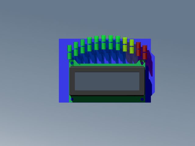

is your part not planar? If it is planar you could do the same thing with a 2d sketch as well. I just did the same thing but created a new sketch specifically for the path(see image). You could also share the sketch used to create your original part or select the edge for your path in a rectangular pattern.

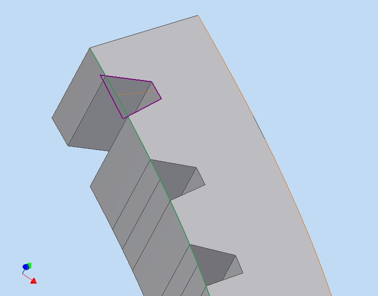

Man,,, I hate to admit it,, but what you just said went over my head, sorry. The front face is made up of three tangent radius's and although I can get these 12 or 13 "teeth" to follow along the path of 3D Sketch per KC's suggestion, I still have 1 or 2 that won't completely cut clean at the top of the "tooth" valley. Hope this make since.

can you post a screen shot of the 2 that wont cut clean?

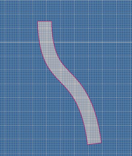

Yeah,, sorry. The sides are flat to one another and perpendicular to the front and back surfaces (front surface being the one that's getting the "teeth" cut into it.) Here's a pic of how far I've got so far. This "thing" is going to be a prototype cut from steel (laser or plasma) that I had to draw from a "carved/cut" wooden piece that some log jockey brought in, get the idea? :?

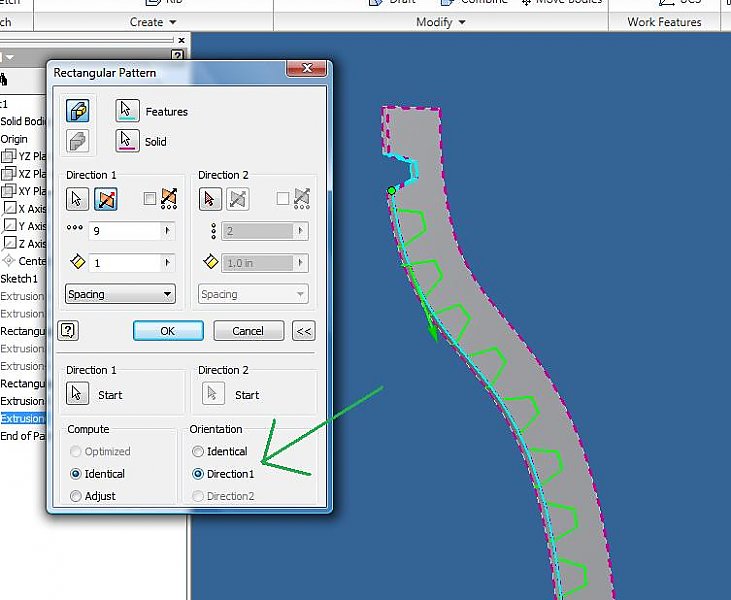

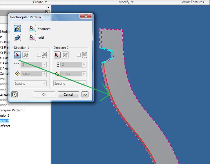

Rectangular Pattern can also be used as "curve driven pattern" . See the AU tutorials in my signature.
the problem is your cut out is actually below the surface meaning the curve you are following is probably going through some negative curvature there because up until that point it was arcing away from the cut. You can solve this by making your cutout larger. Ill try to take some screen shots later on tonight if you havent got it(or someone else chimes in)

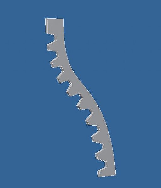

Here are a few screen shots for you bill. The first thing I did was draw your shape with a single spline using only the end points handles to control the shape. What this does is lets me select the edge of my solid as my direction for the pattern without having the addition of any other sketches. creating the shape with a bunch of arcs, even though they are tangent, will produce those separated faces.
Special note on how i created the cut out. I created a line from spline to spline, then a second line that was perpendicular with that one. This perpendicular line then got a tangent constraint with the spline. This is important so that your cut outs orientation is not only right for the first one, but as it travels along the path.
In the 3rd image you can see the red line selected as the direction.
Also note in the 4th image the orientation button is selected as Direction 1. This will adjust the cutout along the spline. There are limitations to this depending on your cutout and the radius you are trying to bend it around.

Today I tried BillB's work and found the same problem. (see pics. the curve is a coplanar spline here)
I used a rectangular pattern as JD suggested and extended the cut, out of the curved surface. As Shift pointed out, I too, thought that was the issue but the result didn't change.
I tried a rebuild all and no difference

I checked the Adjust button under Compute and that did the trick.
