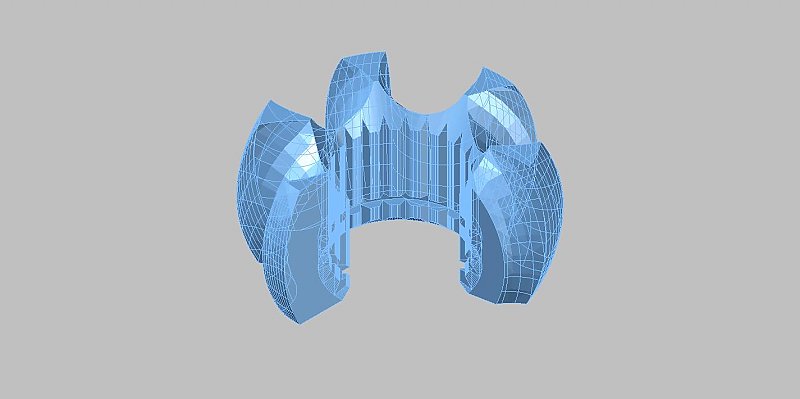

ReMark Posted April 9, 2010 Posted April 9, 2010 Here is an example of something I drew in 3D with AutoCAD 2007. It's a part of my anatomy. It allows my head to swivel. LOL! Quote
SadisticIron Posted April 9, 2010 Author Posted April 9, 2010 That is nice. I am nowhere close to that. I am in the process of trying to make some center pieces for our wedding but I am unable to put text on the side view of a six sided polygon. I can draw it and see it but I can not put text on it to show the lady. Quote
Dana W Posted April 9, 2010 Posted April 9, 2010 ReMark said: Here is an example of something I drew in 3D with AutoCAD 2007. [ATTACH]18722[/ATTACH] It's a part of my anatomy. It allows my head to swivel. LOL! I had a little help from my daughter who knows some equine anatomy, we think that is the C2 cervical vertebrea known as the axis. But, judging by the splines inside the bore, I might also say it is a spur gear (cutaway) inside an autonomous robot's neck drive mechamism. Does DARPA know where you've gotton off to? Quote
