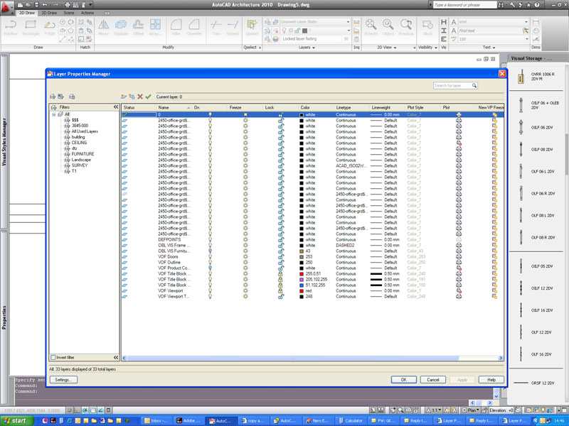

On my computer at home, when I open the Layer Proerties Manager, it opens in an ACAD toolpallette type menu which I can dock/expand/hide etc. On my platform here at work it opens up in a seperate Windows type, well, window.

Both of those bring it up in a window still. It's the pallette version that I wish to use. Confused as to why the same command would work two different ways on two different computers, but I'll be happy if I can just get the dockable one to work. Oh, should have said, I'm on 2010.
Post a screenshot of the problematic manager.
This is what comes up using either commands: LAYER or CLASSICLAYER or the ribbon button (which has the command LAYER also).

Have you tried LAYERDLGMODE set to 1?

Excellent! That's got it. Thanks a lot!
